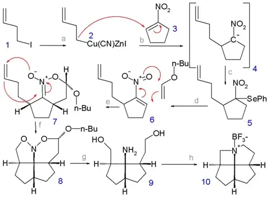

But these substances are exceedingly difficult or straight impossible to manufacture with ordinary chemistry: it's like trying to compress steel springs using tools made of putty. Pyramidanes are only theoretical, and this is the simple and intuitive pathway to azafenestrane achieved only a few years ago:
Nanotechnology, or rather the possibility of large-scale atom-level assembly, changes all that. With nanotechnology you can force atoms in configurations that they would never assume by themselves, no matter what undirected atoms around them might do, and achieve this without the rest of the structure, no matter how complex, collapsing on you and probably taking the whole manufacturing plant with it.
So you build your chemical explosive by arm-bending a very energetic molecule with very strong bonds, one branch at a time.
For example superphanes have an extra strain kick of 84 kJ/mol (compare that to the explosive energy of RDX, which is about 1300 kJ/mol. Not much, but that's extra - and that's for one singly-strained configuration).
It would be theoretically possible to arm-bend and produce a folded-up, densely packed poly-fenestrane compound with 6400 to 10000 kJ/mol strain energy alone (I wouldn't want to guess the stability of that), or even design completely new compounds with even higher energy content. Such a hypothetical polyfenestrane explosive would be around seven times more powerful than RDX or hexanitrobenzene, with a relative effectiveness factor around 13 compared to ordinary TNT.
