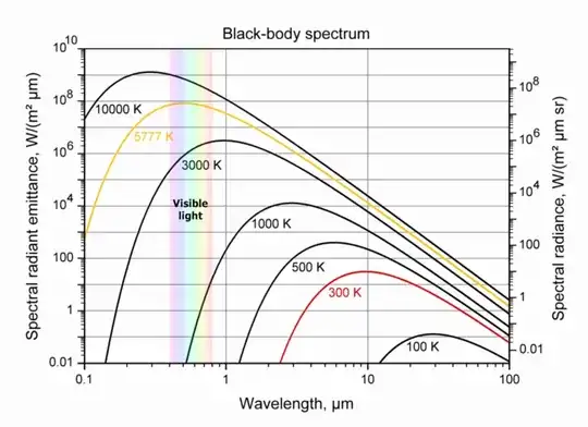

Since more of the sun's blue light will be visible due to reflection in the atmosphere, now it matters what light is coming in the atmosphere in the first place. This depends on the temperature of the sun's surface, which controls its blackbody emission as shown in the graph below from sun.org.
Our sun, as you can see from the yellow 5777K line, peaks right between the blue and violet sections of the sky. This plus the scattering ensures that we see primarily blue in the sky. If we cooled down the sun a bit, to halfway between the 5777K and 3000K lines, we could image a sun that has peak color in the green-yellow region. This light would still look white to us, since all colors would be represented roughly evenly, but when scattered by an atmosphere, more of the blues and greens will come out and you might get the desired turquoise sky.
