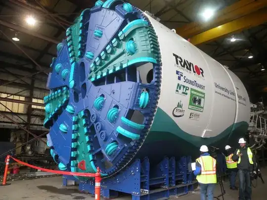

But thing is, I remember that I was quite shocked to learn when growing up that THIS is what REAL bores looked like (and actually they do look quite BORING):
A flat-faced boring machine, used to dig Seattle's link light rail
Hey!? What's going on? Is there a physics or engineering (which I presume) reason why we use this big flat bore instead of the pointy one? I was going to use one in my story/short film but I was conflicted — obviously the pointy one is cooler, but it is kinda based on science soo....
In my quick little evaluation it doesn't seem like either is really worse off, except perhaps maybe the pointy one might become dull at the tip, but is that a really big issue, and would it not be prevalent in the flat one too?

Is there a physics or engineering(which i presume) reason why we use this big flat bore instead of the pointy one?
A minimum area cutting surface is best in hard rock; so disk beats cone.
If memory serves, the flat face of the real tunnel-boring machines is pressed -- with enormous force -- against the rock face, as it rotates. The cutting wheels and teeth generate huge, localized pressures, to fracture away bits of the rock face. The flat, disc face has the minimum area and can be made strong and simply. The real one also has strong hydraulic jacks that grab the already-bored tunnel walls, to ensure that the cutting disc rotates, rather than the body of the machine spinning uselessly. (They also have an impressive system for conveying the ground-up rock, etc. out the back and away.)
A grooved, conical, cutting 'nose' as in the illustration might work in soft soil -- if that machine had something to prevent the body from counter-rotating and a means to move the pulverized soil out behind it.

  • "minimum area cutting surface is best" but the pointy one has WAYY less surface area right?? – John Hon Jan 24 '17 at 13:23
    Nope, the cone has more surface area. Search for the formulae and you'll see. Intuitively: for every narrow pie slice of the disc (say 1 degree), the corresponding area on the cone is a triangle with the same base, but a much longer height, via Pythagorean Th. Then integrate around the disk (or cone) to get total area. – Catalyst Jan 24 '17 at 13:28
  • i do understand ur point but i guess i was thinking about the penertration point (the tip). I guess my logic oculd be a little foul – John Hon Jan 24 '17 at 13:30
  • Threads for fasteners (and leak-tight plumbing) use 'pointy' threads. Drill bits for harder materials tend to be obtuse. Suggest using images.google.com to look at masonry drills. – Catalyst Jan 24 '17 at 13:32
    @JohnHon The pointy one sure will have lower surface area when first getting started, but after you've drilled in at least the length of the cone, the entire cone will be in contact with the bore hole walls. – Shufflepants Jan 24 '17 at 16:22
  • @JohnHon The pointy tip has less surface area, but to bore a hole of the desired diameter, you need then entire conical section of the cone to come into contact with the rock. In that case, the cone has a much greater surface area than the flat-faced circle. – kingledion Jan 24 '17 at 19:14
    also note that most of the light blue parts on the real machine are replaceable (from inside the machine) and wear out quite regularly. and it runs at about 1/1000 th the speed of the cartoon drill – simpleuser Jan 24 '17 at 19:24
  • Also keep in mind pressure is force per area. You can get a much higher pressure when you press a flat borehead against bedrock than with a conical one. So it isn't only the cutting wheel that has to be made sturdy enough but the whole force the boring machine needs to exert on the rock would need to be higher due to the greater total surface area. With a 3:1 ratio for height to radius on the cone in the comic book, the area (and thus the force) would be more than three times greater than that of a flat disk. – Adwaenyth Jan 25 '17 at 12:40

Yes. A bore is essentially a really big drill bit. As such, the shape of the bit is determined by the material you are cutting.
The cartoon bore has a twist bit that has a high twist rate resulting in a large surface area for the swarf (the stuff being removed) to pass by. This will result in lots of adhesion and will cause galling. Large amounts of lubrication will be required to prevent this: water, oil, etc. anything to keep the rock from sticking to the drill bit. The real-world bore uses a conveyor belt to move the swarf rather than a spiraled groove (which is just an Archimedes Screw).
The cartoon bore also has very acute point angle. This is great for drilling through soft materials (clay as James points out), but is terribad at drilling through hard materials like rock. Take a trip to a hardware store and look at the difference between drill bits for wood vs. those for metal or concrete. The angle will determine the surface area faced by the cutting edges, and more surface area equals more friction. Friction creates heat, and heat causes more wear and tear. This will again require more lubrication to draw off that excess heat, but how would you pump all that lubricant to front of a pointy drill bit?
So while the cartoony bore might work, it would wear out quickly, require more lubrication to prevent galling, and ultimately be much more expensive to run (as Molot points out) because you would constantly be replacing a giant bit.

Lots of issues here that make flat better than pointy...most of which can actually be boiled down to a single idea... surface area.
  1. More surface area (a cone) generates more heat.
    • More heat requires more cooling equipment and more maintenance
    • More heat reduces the life of the cutting edges... Heat > Steel
    • More heat is bad for workers underground in a confined space
  2. Geologic stability
    • A cone is going to cause cave-ins more often that the flat guy. The machine (as mentioned elsewhere) is designed to support the weight of the earth it removes until supports can be placed. The cave ins are going to cause you to have to dig, and then re-dig as things fall from above.
The only situation where I can see a cone working better would be a situation where for some reason you want to dig a tunnel into clay...but...why would you want to do that?

The cartoons leave out a very important fact: To make a hole, you have to remove a "hole-shaped" volume of material to some place else.
Wood is fibrous, which means it actually contains quite a lot of air spaces, so if you are inserting a fairly small wood screw, you are just squashing those spaces without actually "removing" any of the wood. The fact that the wood is then trying to spring back and fill up the hole improves the grip on the screw. It is much easier to drive a screw into a wood like pine which contains a lot of air space, compared with a something like oak which has less.
But to make a larger hole that will stay open on its own, you have to remove the material somehow. The cartoon boring machine doesn't have any way to do that, except by material travelling up the spiral grooves, which inefficient because of the amount of friction between the moving material, the unbored material, and the borer itself.
In the real tunneling machine, there are holes in the cutting face along the edges of the cutters, so the cut material can fall through to the inside of the machine, and then be removed with the minimum amount of effort so long as you can remove it as fast as you are cutting more material.
