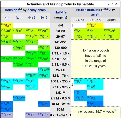

The archeological evidence would be the presence of long lived fission products or activated material from neutrons of fusion bombs.

Nuclear fission creates many radioactive elements. Each has it's own lifespan (measured in half-lifes it is constantly radiating ionized parts of itself off (that's why they are called "radioactive") and becoming other elements, some still radioactive and some stable. Only a few of them would still remain after 2 million years:
Generally speaking, after 20 half-lives, radioactive isotopes have only negligible activity.
So, depending on the technology level of your futuristic society, they might be able to detect some of these remaining radioactive isotopes, even tiny trace amounts.

Nuclear fallout will be around for an long, long time
Nuclear fallout (note: "nuclear fallout" usually refers to radioactive fallout. I will be using a slightly different meaning due to the context of the question). will be detectable until earth is destroyed - if geology allows. I am no expert in formation of rock sediments or the spread of nuclear fallout, so I will assume that nuclear fallout will be preserved in relatively clear strata in e.g. sandstone.
If so, any civilization with a relatively basic understanding of nuclear physics will be able to see that there was a big release of fissile material (uranium-235 and plutonium-239), along with products from fission processes.
An atomic bomb works through a chain reaction in which a lot of either uranium-235 or plutonium-239 fusions (there are a few other choices of isotopes which might be technically possible to use, but they seldom are) . However, not all of the bomb material will be spent; a significant fraction will be released as fallout. This means that a bomb will spread isotopes from three different groups:
- Unspent fissile material
- Decay products from fission processes
- Activated material from surroundings (e.g. bomb casing, air, soil)
We can ignore the last category for our purposes here: the other two will provide clearer evidence.
The unspent fissile material will be either uranium-235 or plutonium-239.
Uranium-235 has a half-life of over 700 million years. Thus, virtually all of it will still be around after the two million years in the question. This will be an excellent clue for the archaeologist: not only will it show that someone spread a lot of expensive, highly enriched uranium over the planet, it will also give them a good estimate of when, as you can analyse the amount of decay products from the decay chain to see how long since this took place.
Plutonium-239 has a much shorter half-life, only 24000 years. This means that after two million years, it will be gone. However, it will not have disappeared entirely, but have also turned into uranium-235. This will mess with the time-span analysis of above somewhat, and introduce an uncertainty of about 100 000 years.
Fission products
Nuclear fission creates a range of different nuclides. In general, these are short-lived and unstable, but they will also generate daughter nuclides that are stable. The archaeologist will thus find a mixture of different isotopes, in proportions that does not occur naturally, in the same layers as the above uranium. This will clearly show that not only has someone spread a lot of uranium-235, but also a lot of fission products.
The theory that would best explain this is an all-out nuclear war:
- Large-scale nuclear disasters are unlikely. They would also release a lot of uranium-238, which would also be detectable. One could postulate a civilization which has reactors that only runs on highly enriched uranium, but that would be an extreme expense without any clear benefit.
- Large-scale deployment of dirty bombs is even less likely, for similar reasons: they would tend to leave a lot of fission products, but there is no reason for there to be a lot of uranium-235 and no uranium-238.
A smart archaeologist (or rather: a team of different specialists) would thus not only be able to figure out that a nuclear war had taken place, but also roughly when it had. This will even be possible as long as there is geological strata generated during the war around to analyse.

A lot of people have mentioned the half-life idea, but nobody has specifically mentioned Cesium 135. It has a half-life of around 2.3 million years and is produced in a fission reaction (I've called it "Humanities longest lasting gift to the Earth" in a previous post). A dust layer with higher concentrations of cesium 135 should be recognizable.

You would need radioactive isotopes that will last beyond 2,000,000 years. In the list of the half-lives of radioactive isotopes this would be the substances with half-lives around 10^12 seconds since 2 million years is about 6.3072x10^12 seconds. You probably need to find an isotope that's part of the decay chain of whatever radioactive material was used to set off the nuclear war in your story.

You don't. You can just as well analyse the decay products to find what they started as. In fact, only finding isotopes that are radioactive would be a clear sign that there was not a nuclear apocalypse, and that the isotopes have been placed wherever you found them by some other means. – andejons Jan 12 '17 at 12:31
@andejons I'm approaching this from a world-building perspective. Since you're a nuclear physicist based on your description I would really be interested in your answer :) – pageman Jan 18 '17 at 10:33
