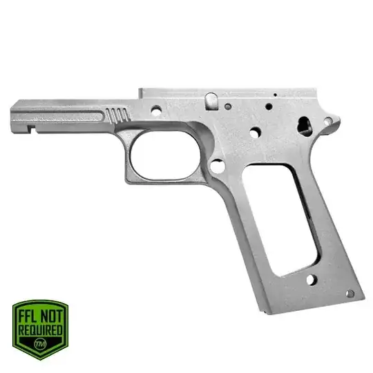

Would such a bullet penetrate the magazine and pistol grip, and shoot out into the world? Could it ricochet and injure or kill someone nearby?
Probably not. Magazines and gun frames are generally fairly robust, and without a barrel to contain and focus the energy the cartridge won't do a lot. Here's a video from the Sporting Arms and Ammunition Manufacturers' Institute (SAAMI) on the subject of "what happens when ammunition burns". The video is a great watch, but the first few minutes will show you all you need to answer this question. Without a barrel to contain them, most cartridges (even rifle and shotgun cartridges) won't blast through plywood, let alone a metal gun frame.

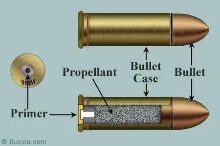

The function of the primer is to create a spark inside so yes if you create a spark inside it will ignite the gunpowder. But I cannot imagine how you would create a spark inside the (sealed) round other than the primer.
An external spark is not going to ignite the gunpowder in the round.

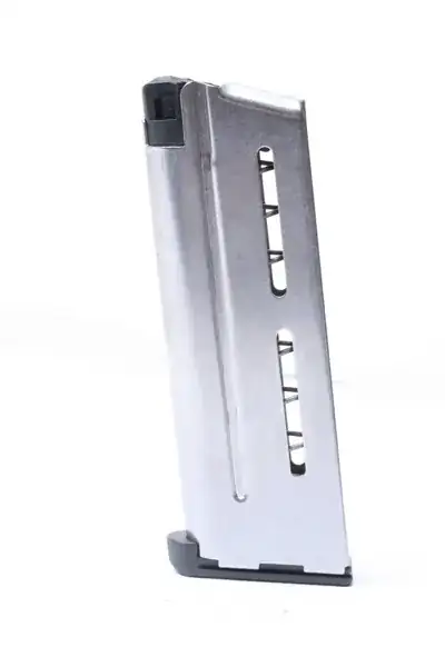

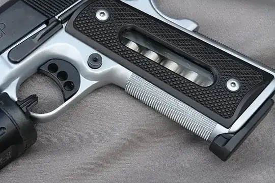

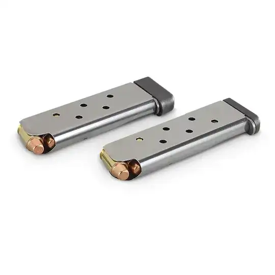

This is a highly firearm specific question. Ammunition in a magazine is not confined in a reinforced tight space like a chamber so the bullet won't fire forward very far.
BUT the front-back tolerances of the magazine may be tight enough that the ignited bullet can NOT push out of the cartridge because it hits the front of the magazine. See how little forward room is available in a 1911 magazine.
This will block the release of gas and allow for a "kaboom!" (KB) inside the magazine which will bust the case and send gas and case fragments laterally. This can be a problem in magazines with ammunition witness holes or lightening slots on the sides of the magazine, now there are weak spots for gas to vent out of.
Pair this with a pistol that has open spaces around the magazine (like the 1911 if you take the pistol grips off) and you have an additional weak spot for expanding gas and fragments.

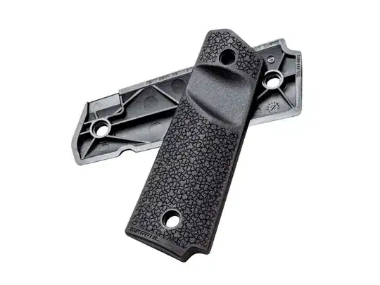

Most grips on steel framed pistols are wood or resin/plastic and can fragment.
So with a sufficiently large caliber round, a magazine with a tight front/back fit that traps the bullet into the cartridge (remember that the bullet is seated a good ways back into the case), and an open sided magazine and pistol frame, you COULD have a KB that cracks the grips and sends out some fragments into the immediate area (like the back of the guy wearing the pistol in a waistband holster). If someone was holding the pistol then their palm or fingertips could be injured (depending on which side blew out).
In general I think most magazines don't have tolerances tight enough to keep the bullet inside the case (but I'd have to check) and they have enough space inside the magazine to absorb all the gas (double stack mags especially), OR the bottom of the mag would blow out first, since the magazine is enclosed all around or the pistol frame is, OR the cartridge won't have enough energy to do any damage regardless. BUT you could have a unique situation where this tactic would work pretty well, like if the bad guys are carrying this pistol...

First, the spark would have to be inside the cartridge and either 1) be equivalent to that of the primer, or 2) detonate the primer, not ignite the powder. Primers are made with explosive materials, making the flakes/balls/rods of powder ignite essentially at the same time, whereas a small spark would ignite some powder, spreading to the rest at a rate much slower that a fired round and result in lower pressure.
Second, the gasses will take the path of least resistance. In the open, a cartridge "fired" would propel the brass much faster and further than the relatively heavy bullet, as described by Newton's laws (momentum, equal opposite). A contained cartridge will split the case and pressure would be released through the ruptures, not by propelling the bullet or casing held together by the magazine. The split casing could, of course, become hazzardous shrapnel, depending on the magnitude of the pressure developed before the casing ruptures.

the spark would likely have little effect since the sealed cartridge has little to no oxygen contained within. The difference between a "little spark" and a primer being discharged (with listed pressures of between 8,000 to 10,000 psi depending on the manufacturer) is substantial. It's the pressure of the primer "explosion" that sets the powder off along with the flame involved. Can't imagine the "little spark" doing much more that causing the powder to smolder. Smokeless gunpowder open to the air will burn with a small spark to ignite it but not in an enclosed chamber without the added pressure from the "starter explosion" caused by the primer being set off.
    Smokeless powder is self-oxidizing and does not need any oxygen to go off. A gun will fire in a anoxic atmosphere, or even in vacuum. – kingledion Dec 30 '16 at 02:22
