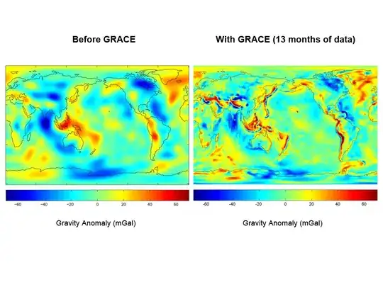

The strength of a gravity field depends directly upon how much mass is adjacent to the observer. Observe, for example this map of our Earth's gravity field by NASA:
The earth in fact has differing strengths of gravity fields depending on what exactly the crust underneath is composed of. Notice the giant low-grav zone in Canada, a well known phenomena, due to the nature of the crust underneath.
Also, note this older article from National Geographic, they mention that the gravity fields change over time (winds and currents move water, which has enough mass to impact gravity): National Geographic Gravity Map Article
Thus a flat and/or disk shaped world would in fact produce normal gravity, IF the mass was relatively evenly distributed across it's surface, and was fairly uniform in thickness. However, towards the edges, and near mountains or oceans, it would get a little weird.
