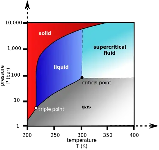

At these temperatures and pressures, there's no dissolved liquids in the Martian atmosphere to make fall out of solution. They will immediately sublimate, convert from solid to gas. To understand why we need to look at some phase diagrams: the temperature and pressures at which various substances are solid, liquid, gas, or other.
Carbon Dioxide
Martian pressure is so low it's off the bottom of the scale here. That means CO2 can never be a liquid.

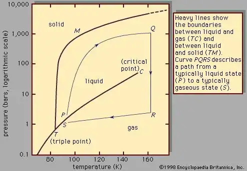

Argon
Argon is a noble gas and very difficult to liquefy. While Mars does get cold enough to make argon a liquid, again, the pressure is far too low.

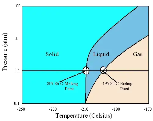

Nitrogen
(Sorry, this one is in Celsius). Again, the pressure on Mars is so low it's off the bottom of this graph. Nitrogen cannot be liquid at Martian pressures. It's also too warm on Mars for liquid nitrogen.
Liquids are pretty rare in the universe. Most substances have a relatively narrow temperature/pressure window in which they're liquid. They much prefer to be solid, gaseous, or plasma. You might be able to make it snow, but you won't be able to make it rain.
