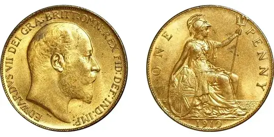

When I was younger, as part of a science summer camp we made pennies turn to gold. I don't know what the bar will be for "looks like gold," but it seemed like a good starting point for me. The process was:
  • Start with copper pennies (not the zinc filled ones we have today)
  • Zinc plate them (which makes them look silver)
  • Heat them over a Bunsen burner until the zinc and copper meld into brass (which looks "gold" to a bunch of kids)

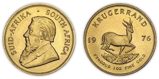

Brass penny Gold Kuggerand

  • What country are those pennies from? – JDługosz Oct 10 '16 at 03:20
    @JDługosz To the best of my knowledge, the penny is British. – Cort Ammon Oct 10 '16 at 03:50
  • So that’s not a picture of the one you made? – JDługosz Oct 10 '16 at 03:52
    Fwiw, the Krugerand is not pure gold and doesn’t have the unique look. It's rather coppory in color. Hold one nedt to a Canadian maple leaf coin in natural light and the difference is striking. – JDługosz Oct 10 '16 at 03:54
    The penny is definitely British - it says "GRA.BRITT." on the heads side and has Britannia on the tails, complete with a union flag on her shield. – N. Virgo Oct 10 '16 at 03:56
    @JDługosz No, that wasn't my own. The one I made was decades ago =) And interesting insight into the Krugerrand. I chose it of all the gold coins because it had the most similarity to the brass one I chose, so I suppose it makes sense that it's an odd alloy. – Cort Ammon Oct 10 '16 at 04:31
    An alchemist that is unable to recognize bronze seems a bit of a stretch though. Especially if he made it by mixing copper with other metals. – Taemyr Oct 10 '16 at 08:36
  • So where did you get the picture of the plated penny and krugarand under the same lighting? – JDługosz Oct 10 '16 at 09:50
  • (91.67% Au, 8.33% Cu) isn’t odd, but common for coins meant to be durable and casually handled. The U.S. coins use silver and copper, I suppose so the color is nicer. – JDługosz Oct 10 '16 at 09:55
    For the benefit of those who don't know, the penny coin from the picture here is indeed a British coin. This was the standard issue penny coin for many decades, only changing when the British currency was decimalised in 1971. It always struck me as being a remarkably large coin considering it's "only" worth a penny; even in 1910, when a penny was worth a lot more than it is now, it still wasn't that much, and in fact the thruppeny bit (3 pence), half shilling (6 pence) and shilling (12 pence) coins were all considerably smaller, as too were the half penny and farthing (quarter penny) coins. – Simba Oct 10 '16 at 14:37
    Zinc & Copper is brass, not bronze (Copper & Tin), but it does have that goldish kind of look and would seem to satisfy the question. – komodosp Oct 10 '16 at 14:56
    @colmde Good catch! Edited – Cort Ammon Oct 10 '16 at 15:26
    @JDługosz Sheer luck? I can only assume that there is a "correct" lighting to photograph coins as far as numismatists are concerned, because you're right -- its almost creepy how similar the lighting is! – Cort Ammon Oct 10 '16 at 15:27
  • Standard way to photograph coins: never heard of such a thing, but I expect the glare-free light with enough directionality to bring out the detail will be a natural solution. I’m more interested in the color: calibrated? Were those taken together under the same light? Was this a report of someone else’s penny plating effort? – JDługosz Oct 10 '16 at 18:10
    @JDługosz Those are two different pictures from different sources. And the penny shown here was actually brass, so no additional plating was needed. I couldn't find a good picture of a US penny after brass plating. – Cort Ammon Oct 10 '16 at 19:43
    This is not important, but @Nathaniel appears to misinterpret the inscription on the penny: GRA doesn't stand for ‘Grand’ (or any cognate thereof). In full, it reads Edwardus VII, Dei Gra[tia] Britt[anniae] Omn[is] Rex, Fid[ei] Def[ensor], Ind[iae] Imp[erator] (Edward VII, by God's grace king of all Britain, defender of the faith, emperor of India). – Anton Sherwood Oct 11 '16 at 04:56
    @AntonSherwood thank you, I appreciate the correction, even if it isn't at all relevant to the main point :) – N. Virgo Oct 11 '16 at 05:01
