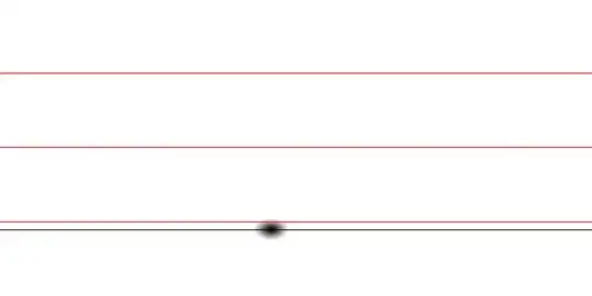

Here is a equirectangular projection of how the hit would look. red lines are 0 and 45 degrees, black line is 50 degrees. The circle is the rough size of your crator on an earth map.

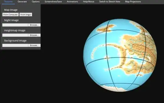

You can DL this and see how it projects on a 3d globe as well as a number of other projections Here
Basically, all you have to do this is draw a circle and squash 60-70% on the north and south side. I could have made it perfect by getting the exact number from wiki, but I just thought of that this instant and don't feel like editing so... blah

  • I don't know if your graph is showing correctly on my phone. I'll check tonight at home and might come back with questions. – EveryBitHelps Oct 04 '16 at 15:20
    @EveryBitHelps This is a 1000x2000px image. The roughly 12miles per pixels. And there is indeed a calculation you can use for mercator maps, though I've never used it cuz I suck with that stuff. But anyways the link I put in the answer should help you immensely... Also I'm thinking about it and I probably did it wrong, not sure I probably should have stretched the east west rather than squashed the north south. – Durakken Oct 04 '16 at 15:30
  • Wow. Just opened that link on my phone and it looks so cool. Will have a definite look at home on bigger screen! – EveryBitHelps Oct 04 '16 at 15:35
    @EveryBitHelps Yup I found that some time ago and I need to figure out how to get the source code for it just in case the maker ever decides to delete it ^.^ It's just 1 of many tools for map making that there are. – Durakken Oct 04 '16 at 15:47
  • This is not a Mercator projection, it's an equirectangular projection. – Kyle Oct 04 '16 at 19:10
  • @kyle thanks and corrected ^.^ I always forget projection names :P – Durakken Oct 04 '16 at 19:41
  • @Durakken, OMG!!! Thank you so much for that link! It is amazing. It just transferred my flat map to a sphere. and now I can rotate the view of the 'planet'! THANK YOU!!!! – EveryBitHelps Oct 04 '16 at 19:48

    @EveryBitHelps The 3d height map bit kinda sucks, but if you know what you're doing you can do some pretty cool things with it. It also has a distance calculator on it so you can measure from 1 spot to another. – Durakken Oct 04 '16 at 19:55
  • @Kyle I just don't deal with them that much. I use the same one all the time and only see the other ones when I have something to do with it comes up and i go to the wiki page or i see all the other weird ones and wonder if those are actually real or not lol – Durakken Oct 04 '16 at 19:57
    @Durakken, The source code can be found on the Bitbucket repository (the "readme" link in the Help/About menu). And since hosting it from Bitbucket is free, I don't have any plans to delete it :) – Braffin Oct 06 '16 at 19:41
  • @Braffin Cool. Didn't know that. >.> Since you're reading this, mind explaining what Night Image is and how it works, because I douldn't get it to ^.^ – Durakken Oct 06 '16 at 19:53
    @Durakken, well you made me realize that I really do a terrible job at explaining how to actually make the Night Image work. You have to enable the atmosphere option to make it work. Then, if you upload a night map image (something like this) along with a normal map image, the result looks like this. – Braffin Oct 06 '16 at 20:53
  • @Braffin Ahhh I see cool. The only problem I have with what I'm seeing is that the "night" blacks out the base texture instead of laying on top of it and making dark, but still seeable. I assume you're using something like white represents high brightness and if you don't get significantly white the night side will always be deep black. – Durakken Oct 06 '16 at 22:19
