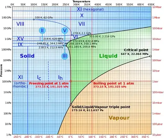

This is a surprisingly hard question, and depends on the radius and mass of the water planet in question. A water planet of Earthlike mass would definitely not have an Earthlike radius, and it's difficult to say exactly what its radius would be precisely because water is so damnably weird with so many different crystalline structures at different temperatures/pressures.
Have a look (and mind the logarithmic nature of the Y axis, and the moderate range of temperatures covered):
By Cmglee - Own work, CC BY-SA 3.0, https://commons.wikimedia.org/w/index.php?curid=14939155
Every labelled region on that diagram has different structural properties. As a point of reference, pressure at our planet's core is estimated to be in the neighborhood of 330–360 gigapascals. Since Earth is made of much denser stuff than water, we can probably take this a comfortable upper bound on an earth-radius water world's internal pressure. As you can see from the phase diagram, water at this pressure would be Ice X (assuming a moderate temperature, which is a poor assumption at a planet's core, but these are the data I could find), distinguished from Ice I–IX by its novel crystalline structure. In fact, Ice VII, X, and XI are the only ones one this diagram suggests could exist in a planet's core (which would, again, be very hot as well as under great pressure). The boundary between fluid and solid phases of water also goes to higher pressures as temperatures increase. In a particularly hot and small world, you could find plain old liquid water at the core, or more likely water existing as a supercritical fluid. 2
It is hypothesized that at even greater pressures, well above 1000 gigapascals, water would take on metallic properties. You'd need a truly massive water world for that to occur naturally at its core, however, perhaps approaching the limit of stellar fusion. Jupiter is thought to have internal pressures in excess of 3000 gigapascals, but Jupiter contains some materials significantly denser than experimentally verified phases of water, and is as you know, quite large. In addition, at least one theoretical prediction regarding the metallic phase of ice expects it to occur only at pressures in excess of 5000 gigapascals. (However, those endorsing more moderate theories placing it nearer 1000 gigapascal do indeed expect metallic ice to exist within Jupiter.) This site (http://www1.lsbu.ac.uk/water/water_phase_diagram.html) has extensive information on phases of water, including a more expansive phase-diagram that includes water as a supercritical fluid and the metallic phase of ice, though the latter is only theoretical.
