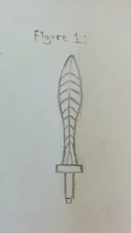

The "whipsword", in theory, should be feasible to build, but using would require a lot of practice.
In fact, I've designed this on paper once, but didn't have the resources to build and test it at the time. I'll redraw and share the design here now (Using semi-gladius shape as base):
In the locked position, it would look very much like a normal sword, but with small lines separating each individual section (See Figure 1).
Figure 1
A button could be placed on the bottom of the handle in order to "lock"/"unlock" the weapon. This button could also potentially be designed as a trigger where the index finger is placed - in fact, how the mechanism is activated is almost completely up to you as the user.

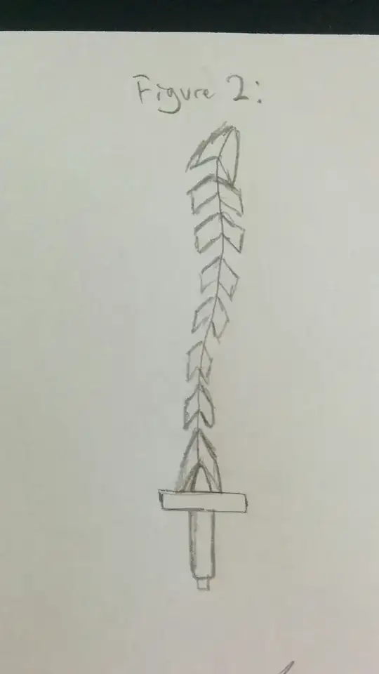

What this "activation" would actually do is simple: When pressed in the locked phase, it releases the lock on a spool of wire, allowing the pieces of the sword to extend and flex outwards (See Figure 2).
Figure 2

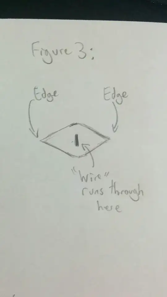

Each piece of the swords would be designed to allow the wire to run through it - with the exception of the tip piece, which would secure the end of the wire (See Figures 3 & 4).

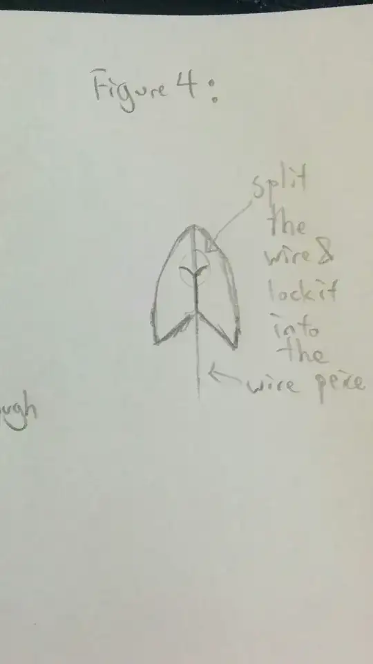

Figure 3 Figure 4
In order to help align the sword pieces properly when retracting the wire, instead of using a circular wire, use a flat piece of metal, aligned perpendicular to the edge of the blade (Refer to Figure 3 & 4). By using the flat piece of metal, you can help "influence" the direction which the blade will flex in. Since it's aligned perpendicular to the edge, the blade will be inclined to curve in 2 specific directions - the edge directions, which helps to allow for easier slashing using this weapon while unlocked.

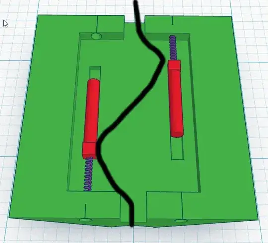

I think it would be quite possible to make today, but rather difficult to construct with early technologies. I've done some pondering and to me it seems the hardest part in constructing this would be having the segments stay apart from each other and not just slide all the way to the end of a wire, once the mechanism is released, due to the momentum of swinging it. It would have to implement some sort of locking mechanism to keep the segments apart. And i think i have figured just the thing. This is a rather crude mock up. Whip Sword Cross-section
This is a single segment that would be in the default state, each pin (red) is pushed into the segment before and after with a spring (purple). the wire (black) is locked into the left side pin and looped around the right side one, like a pulley.The first segment's pin could be magnetically locked into the handle of the sword, or else wise if using earlier technology.enter image description here when the locking mechanism is released the sword when swung would then be able to extend using the extra wire between the pins moving them like so. The tension of the springs would have to be high enough that the sword would return to normal shape after a swing, but low enough that the momentum of the swing would separate the segments. As for ease of use and effectiveness, maybe if you are a skilled swordsman fighting against and unarmored peasant. But anyone with combat training would just bat the thing aside and stab you. Fancy and cool looking, but not a feasible weapon.
