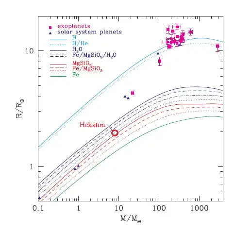

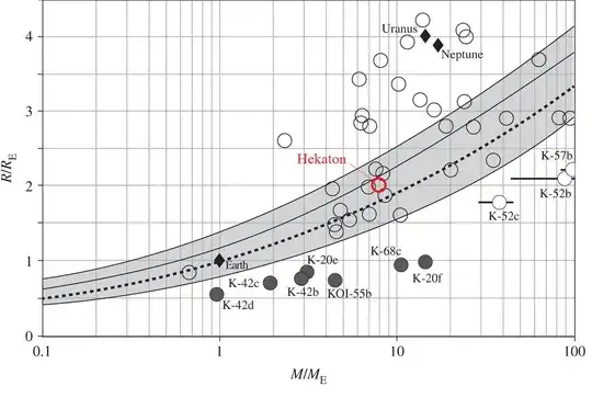

- Can a chthonian planet be as small as this? I read that most potential chthonian planets are estimated to be at least 30 earth-masses, but could easily be smaller, and that hot Jupiters and the like often have unusually low densities.

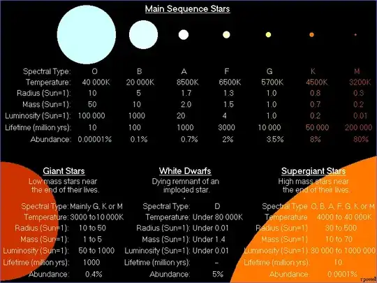

- Would a blue giant be too hot to support this surface temperature? I chose a BHB blue giant because of its UV output, so that Hekaton can have deadly sunlight without being too hot, but if there's a better type of star for this, I'll happily switch.
