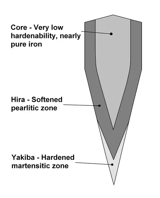

By analogy, look at a traditional Katana. The blade is actually a complex three-dimensional structure, with levels of harness being created by controlling the tempering of the metal (for example, coating only part of the blade with clay when heating and quenching, so the coated parts have a different temper and are softer than the exposed cutting edge. (The hamon; wavy pattern along the side of a traditional Katana marks where the clay coating was applied.
A diamond edged blade made along the same principles would be incredibly sharp yet still be flexible enough to use without worrying too much about breakage. For movie fans, you could create something like the "Green Destiny" sword from "Crouching Tiger Hidden Dragon".

18The only reason the katana construction works is that the different phases of steel have the same Young modulus. If you tried it with diamond and iron, you may as well have made it hollow; a good impact will make the diamond layer shatter and leave you with a useless iron core. – Mike L. Apr 22 '16 at 20:30
