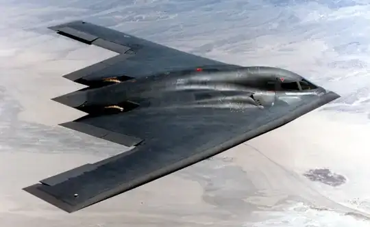

Passive measures will deal primarily with the shape of the car. Highly angular surfaces that reflect the radar away from the gun should be effective. Basically, you'll get a car that looks like the USAF F-117.
If you have the compute power, you can work out radar sneaky curved surfaces which will get you airplanes that look like the USAF B-2.

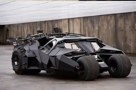

1The batmobile is a classic example of cargo cult stealth: paint it black and make it angled. Those angles probably don't work, there's all sorts of junk and sharp edges sticking up to reflect radar, and radar reflects really well off rotating surfaces like turbine blades (note the engine intakes on the stealth aircraft are shrouded) and fat tires mounted on the front of your car. – Schwern Apr 20 '16 at 17:05
@Schwern, well, I don't like cargo cults either and I can't think of a place where a real stealth car has been made. Reference to the batmobile removed. – Green Apr 20 '16 at 17:25
2@Green Excuse me, I wasn't criticizing its inclusion but adding to it. I think it's a great part of the answer for exactly the reasons I gave: shape (plus a lot of math), not materials or paint, is the primary factor in stealth. And it comes at the expense of aerodynamics. – Schwern Apr 20 '16 at 17:36

The stealth aircraft reduce their radar cross section primarily in two ways: shape that reflects the radar waves away from their origin and radar absorbent materials. Those measures aren't perfect but they reduce the target's visibility to radars, which makes it a lot harder to acquire and maintain lock on it, which is primarily useful for avoiding stationary SAM sites. However if the airplane passes too close or is poorly oriented it can still be locked on and shot down. Which is why it is not a very practical solution for a car, as the car will be radared from very close range where even minor imperfection can give sufficient return, and the cop radar doesn't need to maintain lock for 30 seconds to tell speed.
