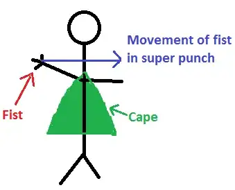

Maths
Lets see what the maths says. First lets understand the mechanics of a super-punch. Super person starts with their arm extended behind them and uses their super strength to move their fist forwards (see diagram)
super person
Next we'll make some assumptions;
  1. a person's whole arm represents on average 5.3% of their body weight.
  2. from what I see on TV most super people seem to be American. The average North American weighs 80kg.
  3. the arm is accelerated by the maximum force possible for the whole distance of the punch (blue arrow) which is the same as a person's armspan
  4. a good armspan for a super person who was good at punching might be 2.1m.
  5. the super person exerts the maximum force on their fist while remaining stood in place (they do not recoil and send themselves flying off their feet)
We have simplified to put the entire arm weight at the fist, but this will make the punch stronger and is fitting to a super person.
The maximum force exerted on the fist is determined by the frictional force on the super person's shoes. A good shoe will give a coefficient of friction of around 0.6. That means the maximum force is;
$$ F_{max} = \text{coefficient of friction} \times \text{mass of super person} \times \text{gravity} $$
The acceleration of the fist is given by Newton's second law;
$$ F = ma $$
so acceleration is;
$$ a = \frac{\text{coefficient of friction} \times \text{mass of super person} \times \text{gravity}}{0.053 \times \text{mass of super person}} $$
Next we find out how fast the fist is moving when it hits. For this we need the equations of motion, specifically the velocity/displacement equation;
$$ v = \sqrt{2 \times a \times \text{distance}} $$
which gives us;
$$ v = \sqrt{\frac{2 \times \text{armspan} \times \text{coefficient of friction} \times \text{mass of super person} \times \text{gravity}}{0.053 \times \text{mass of super person}}} $$
which is around 21 m/s or 47mph. After I did the calculation I did a quick google of "fastest punch" and came across Keith Liddell. He is the current world record holder of the fastest punch, registered at 45mph.

    You had everything to be the best answer: all scientific and such. But you don't answer what was asked! :( what's more, you create an assumption (the person won't recoil) which goes against the exact question, that was "what will happen, will they recoil?" I was so eager to upvote this... :/ – msb Mar 31 '16 at 18:19
    Neat drawing. :-) I fixed up your post with proper formatting of the formulae. – user Mar 31 '16 at 18:23
  • There are a lot of good answers here. One assumption that comes up is that only the weight of the arm needs to be taken into account. A properly formed fully extended punch is primarily powered from the legs. The body posture is such that the rear leg takes much of the force of the recoil. If such a punch is fully committed, the puncher's momentum can carry them forward a couple of steps when they miss their target. This means that instead of 5.7% of the body's mass being under consideration, a much larger percentage comes into play (thumbnail guess 30%' based on gut feel trig). – pojo-guy Apr 01 '16 at 02:00
  • It also changes how the coefficient of friction affects the overall motion, because at a certain point it would be like throwing a good punch while standing on wet ice. It can be done, but it takes practice. – pojo-guy Apr 01 '16 at 02:00
  • I agree with @msb, the math is useful but the first assumption already breaks it. – Tomáš Zato Apr 01 '16 at 09:15
  • What if I jump, then punch you while I'm in the air? The coefficient of friction between my shoes and the air is essentially zero, but that punch is still going to hurt, right? There's more to punching than how fast a fist is moving. – Phil Frost Apr 01 '16 at 10:32
  • You need to add some info. For example you dont hit with the maximum extended arm, you make sure the target is about a bit more than half an arm away, thats where your muscles are the strongest on impact and you can keep exerting extra force as your aim is behind the target, rather than on the target. Then theres how to punch: you dont just stand there, you step forwards to add velocity and swing your entire body with the punch, so body velocity after a quick step needs to be added to the equation that counters the force that pushes you off-balance. – Demigan Dec 15 '18 at 22:24
