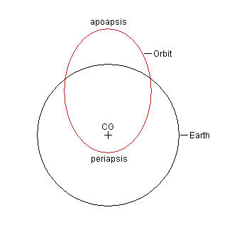

It is not possible to throw something into orbit, and it doesn't matter how fast or how much energy you use.
You don't need any knowledge of orbital velocities or rocket equations to know this cannot work. The simple fact is this: you cannot achieve orbit by using only a single impulse, like a cannonball from a cannon, or a bullet from a gun, or a giant blob throwing bits of itself. The projectile will always go up, around a bit, and back to hit the surface. In practice, it'll immediately burn up when attempting to leaving the atmosphere, and if anything survives that, it'll burn up when re-entering again.
The following diagram may help:
The points where the red orbital line and the surface of the planet intersect are the launch and impact points. No matter what angle or speeds you launch at, this red ellipse always passes through the launch point.*
So after launching, all rockets, bullets and blobs only travel in a large arc. The rocket engine can be (and usually is) turned off slightly after launch, just after getting out of the atmosphere, and the ship, bullet or blob would coast all the way to the highest point. It is here, at the apoapsis, that a second burn needs to be made, accelerating the projectile. This accelerating raises the periapsis (the shortest distance from the planets center to the ellipse), eventually raising the periapsis above the surface. When the periapsis has been raised higher than the atmosphere, the rocket will go around and around with no further input.
The first impulse (or burn) also needs to keep the speed low, to get through the thickest bottom layer of the atmosphere without losing all the energy to friction, or without overheating, or exploding due to aerodynamic stress. The more energy you try to add here, the worse these problems get.
  • There is only one possible class of orbits achievable by a single impulse. In a pure vacuum (no atmosphere), if you launch exactly horizontally at high enough speed, the launched projectile returns horizontally to the launch point, tangental to the surface. The faster you launch, horizontally, the higher the appapsis will be, at the opposite side of the planet. But at the launch site, the altitude will always be zero. Any mountains near the launch area would be a problem (as is the vacuum to your lifeforms).
The only time anything unpowered leaving the surface with a single impulse can get to an orbit above an atmosphere, is if it is hit by something else when near its apoapsis, providing the second impulse and accelerating it in the prograde direction (so it gets rear ended, speeding it up in the direction it is travelling). It is theorized that a load of melted rocks were blasted out from earth in a gigantic collision, and they bumped each other, forming orbits, which coalesced into the moon, eventually, and anything that didn't get bumped just right rained back down.
TL;DR: You can't get something into orbit by throwing it. Orbital mechanics says no. This is unfortunate, because if you can get to a stable orbit, you have all the time in the universe to deploy a solar sail and eventually float away somewhere else.
You CAN however, break free entirely, with nothing more than brute force. You just need to somehow survive getting through the atmosphere at speeds higher than escape velocity. This will mean burning up, like a shooting star in reverse, but given sufficient ablative protection, it may be possible. Escape velocity, at ground level, is Mach 33 (12km per second), but that speed will decrease rapidly due to friction and drag forces, so the actual launch would need to be much, much faster indeed.
It would require much greater sums of energy than rocket launches, since its very inefficient. But as long as the projectile gets through the atmosphere above 12km/s it will fly off into an orbit around the sun. And that's in theory enough to make it to any point in the solar system and beyond, given aeons of time and the right gravity assists.
