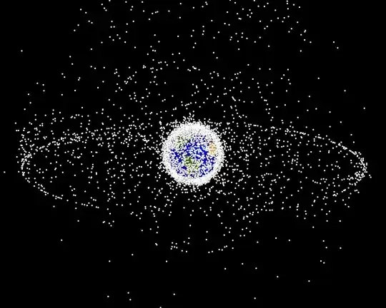

Have a look at This:
That's a picture of the space debris ALREADY in orbit around the Earth — not only that, but that image is over 10 years old. With a bit of shunting and maintenance (ok, a lot of shunting and maintenance), all of that debris could theoretically be aligned into a single plane, forming what would look an awful lot like Saturn's rings as the density of material on that plane was increased.
Interestingly, this also provides a reason for the "Why?": There are already serious issues trying to get stuff into orbit because of collision threats with space debris. If you could restrict debris to a single plane it would provide vastly greater launch windows, you wouldn't have to worry so much about debris shielding for launch, and it would theoretically prevent the Kessler Syndrome ever becoming reality. Plus, it would look pretty.
There would obviously be issues to content with — safe paths for satellites orbiting on intersecting planes, for instance — but it's theoretically far more feasible than actually creating Saturn's rings. As for the technology involved:
- The debris is already all tracked - that image is a computer model based on tracked debris, so they know where it is at the moment.
- Advanced knowledge of mechanics and physics would give you the ability to calculate the required force to redirect an object onto a different orbit - "Mankind" can certainly already do this
- Actually getting everything onto the new orbit would be the challenge. It would take an awful lot of time and an awful lot of manoeuvrable spacecraft, plus some method of "Sweeping up" the small stuff and transferring it to the new orbit wholesale.
- We'd probably need to have some way of keeping it there. Saturn's rings have been around for billions of years, we can't tell how much originally drifted away or into Saturn, neither of which are cases that we can afford.
The first two bits (planning it) are well within current technology. The Latter two, I don't know. Possibly, but it would require a massive amount of planning and resources, not to mention coordination between global powers! There is certainly tech to be created (like that sweeping brush) for which the physics would be tough, but not beyond human ingenuity, I would think. It'd just need a plausible enough reasons to get the money and people behind it.
