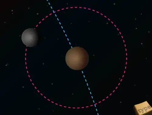

Usually it's relatively safe to say "the moon orbits around the planet", which leads most people to visualize orbits like this:
Fig 1. (As with most diagrams like this, it's not to scale; the moon would be much farther away! But then it'd be very small on the diagram.)
The light blue arc is the planet's orbit around the star. The pink circle is the moon's orbit around the planet.
With Earth's moon, the above diagram would tell the tale (more or less), because our moon is much less massive than the Earth.

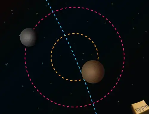

However, with a moon that is about half the mass of the planet, the gravitational pull of the moon on the planet becomes significant, and this is what you would see instead:
Fig 2. While the "planet" and "moon" are (still) not to scale, the inner/outer orbit circles are approximately to scale! That means the planet would be heavily "yanked" around by the moon. The planet and moon orbit a common center point known as the "barycenter", and they both then orbit the star (light blue line, as before).
This is known as a double body system, but for our discussion, I'll stick with "planet" (or "primary") and "moons" (or "satellites").
Fig #2 is the most basic way to arrange the orbit. As with any system, the orbits could be elliptical, and/or eccentric (where the ellipses overlap each other, like my 2nd diagram in this question about binary stars, which follow the same basic rules.)

Note that your fig 2 is pretty much what we do have with Pluto and Charon. – user Feb 18 '16 at 15:45
