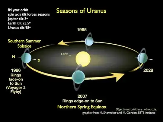

The planet Uranus in our own Solar System has the rotational axis pointed more or less at the Sun, which provides decades of light at the pole, followed by decades of darkness as the planet orbits the Sun.
While a planet the distance of Uranus isn't likely to have any sort of vegetation, much less a jungle, an Earth like planet in the habitable zone might be able to support jungles. The hydrological cycle will need to be carefully mapped out to ensure that the proper amount of rainfall is available (perhaps each pole has an ocean or sea which is constantly illuminated during the "summer", something like the Arctic Ocean here on Earth), and of course the vegetation and wildlife will either have to hibernate during the winter during the dark period, or evolve to rapidly migrate across the planet as it orbits the Sun.
This means that the jungle will be at the "north" pole during the summer, migrate towards the equator during the spring and fall, and eventually establish itself on the "south" pole during the winter (as seen from the north pole).
Since plant life will have to grow and spread with incredible rapidity in order to follow the Sun, you can expect rather unusual conditions in the jungle, including explosive growth of creepers, vines and roots to establish the plant life and take advantage of the changing light conditions, explosive seed pods to "fling" seeds into the zones about to become illuminated and perhaps carnivorous plants that gather nutrients from animal and insect life, since the soils will probably be quickly depleted and lacking a lot of organic matter. Plants will also compete ferociously in order to get as much light as possible, so animal life evolved on this world will probably need to be either very small and fast, or large and armoured. Plants might have some limited sort of intelligence to take advantage of every aspect of the environment as it becomes illuminated, while the herbivores will also be much smarter, since "sneaking up on a plant" will become an actual survival skill. One can only wonder how much smarter the carnivores will be...
