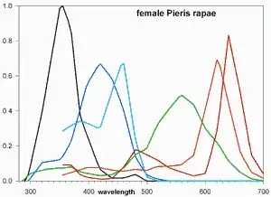

But What about Butterflies?
So, the reason butterflies are interesting to this discussion is that their optics support seeing seven to ten unique color bands, where we old humans see only three (even though they overlap at points). If you're discussing changes to the human eye, you may want to consider adding in a few more cone receptors that are sensitive at different wavelengths. Why?...

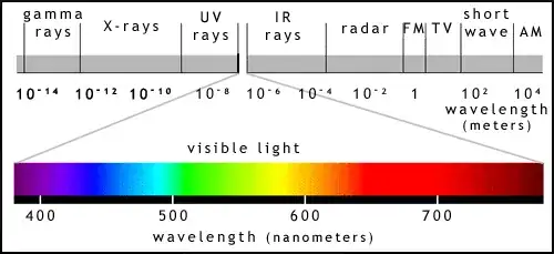

Second, the IR and UV ranges in the EM Spectrum are very large...
Have a look at this image, you'll see just how sensitive the human eyes are to very narrow ranges of the entire electromagnetic spectrum. The entire UV and IR bands, combined, are approximately 10x the size of the narrow visible light band. enter image description here
So, in order to see the entire IR spectrum, or the entire UV spectrum, and still have enough sensitivity to minor changes in the response of wavelength fluctuations, you'll need eyes that have more cones.Like the pieris rapae:
Imagine all those cones spread out over the IR range? Might need a few more.

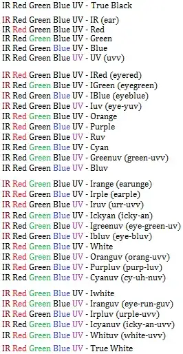

If it worked though, the person would have a vastly increased color space. The difference between red and IR would be blatantly obvious to these people, along with the difference between blue/violet and UV. There would also be a difference to them between green, and green with IR, or green with UV, or green with IR and UV.
Primary Color Chart for Pentachromat.
There would be 1 null color ("true" black), 5 primary colors (one for each cone), 10 secondary colors (each combination of two cones), 10 tertiary colors (each combination of three cones, which is also the combination of absences of cones), 5 quaternary colors (each combination of four cones, or absence of 1 cone), and 1 everything color ("true" white). Plus all the trillions of intermediate colors. I took the liberty of naming them and coming up with tentative pronunciations. Those aren't ANSI standard naming conventions or anything.
The specifics of what real-world objects translate to what pentachromatic colors depends a lot on exactly what response curves you use. Also, it's possible to move the existing cones so your guys' "red" wouldn't correspond to normal red.
For example, you could have IR equate to far-ish IR, Red equate to near IR, Green equate to red/green, Blue equate to green/blue, and UV equate to UV. This gives you a really broad spectral range, but you lose a lot of human color response. To normal people, you'd seem red-green color blind.

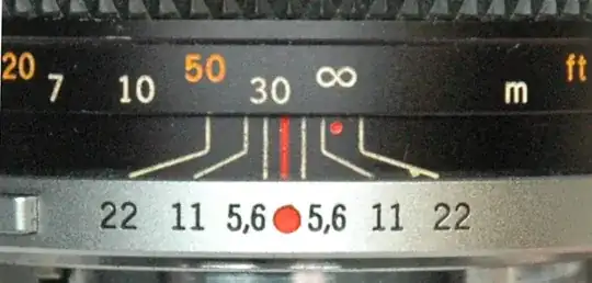

With film, you have to adjust the focus for IR light.
That red dot is where the IR is focused. The red line is where visible light is focused. If you are looking at something that is 7 meters away, something that is 10 meters away will be blurry in IR. This is because of the chromatic aberration that you get with a simple lens (such as the ones in our eyes).

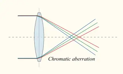

This is because different wavelengths focus to different distances:
If you look at the human spectral sensitivity, you will see that we try to account for this:
human vision
Red and green are close together in wavelength and sensitivity, and we focus our eyes for them. As noted in hyper physics, there are some funny things that our brain and eyes do with blue light:
The "blue" cones are identified by the peak of their light response curve at about 445 nm. They are unique among the cones in that they constitute only about 2% of the total number and are found outside the fovea centralis where the green and red cones are concentrated. Although they are much more light sensitive than the green and red cones, it is not enough to overcome their disadvantage in numbers. However, the blue sensitivity of our final visual perception is comparable to that of red and green, suggesting that there is a somewhat selective "blue amplifier" somewhere in the visual processing in the brain.
The visual perception of intensely blue objects is less distinct than the perception of objects of red and green. This reduced acuity is attributed to two effects. First, the blue cones are outside the fovea, where the close-packed cones give the greatest resolution. All of our most distinct vision comes from focusing the light on the fovea. Second, the refractive index for blue light is enough different from red and green that when they are in focus, the blue is slightly out of focus (chromatic aberration). For an "off the wall" example of this defocusing effect on blue light, try viewing a hologram with a mercury vapor lamp. You will get three images with the dominant green, orange and blue lines of mercury, but the blue image looks less focused than the other two.
And so, while you may be able to see in those other parts of the spectrum, it won't be focused at all and may be hard to use outside of a blur around the green objects (that remain within the traditionally visible spectrum of light).
