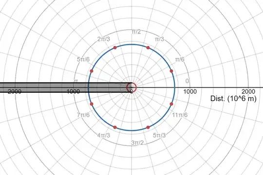

For reference, this is what the orbital situation looks like:
Here, the blue circle is the orbit of the moon, the red circle is the "surface" of the gas giant, the black area is the shadow cast by the gas giant, and the red points indicate when a "new day" starts on the moon. Every "week" (eight days here), there's a roughly-3-to-4 hour period in which the moon is in the shadow of the gas giant and therefore completely devoid of sunlight.
