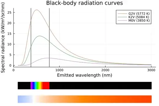

ETA: star colors.
These curves are derived from Planck's law of black body radiation. The first bar undeneath shows the portion of the emitted spectrum that's visible, and a plausible representation of its color. Underneath that is a color temperature indicator which shows the rough color of a star whose spectrum peaks at that point.
This should help show you some of the tradeoffs here... a bright G-class star like the sun has lots of shorter wavelength light, but the downside is that it has more blue light to scatter away and more UV light to form hazes. A cooler K-class star produces proportionally half as much UV (there's a hand calculator for thus on hyperphysics) but there's still a lot of blue and proportionally more red that needs to be absorbed. A cooler still M-class star produces much less blue and UV but then there's much less green and a lot more red to deal with.
