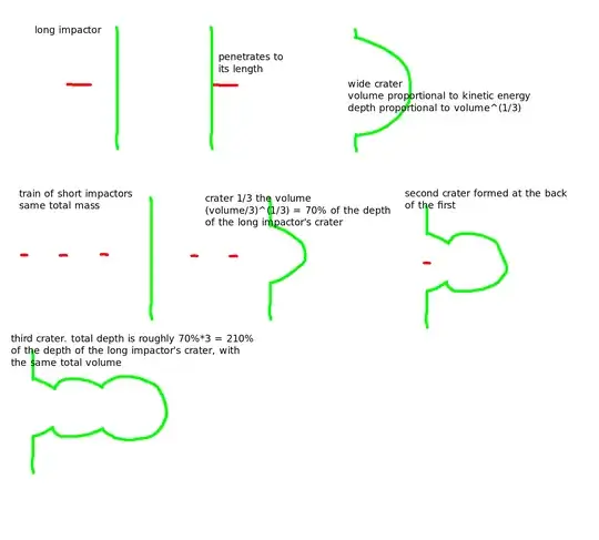

But what if instead of one long impactor, the attacker sent a "train" of little ones, lined up with each other, with significant empty space between one impactor and the next? The idea is that each little impactor makes a little crater. Then, a few microseconds later, the next one in the train hits the back of the crater, making another little crater deeper inside the armor. And so on. I've made some state of the art CGI to illustrate:
The maximum depth "drilled" by the train could be increased almost as much as you want just by making the impactors smaller and having more of them, for the same total mass. The main engineering challenge for the attacker would be making sure all the impactors lined up precisely one after the other.
