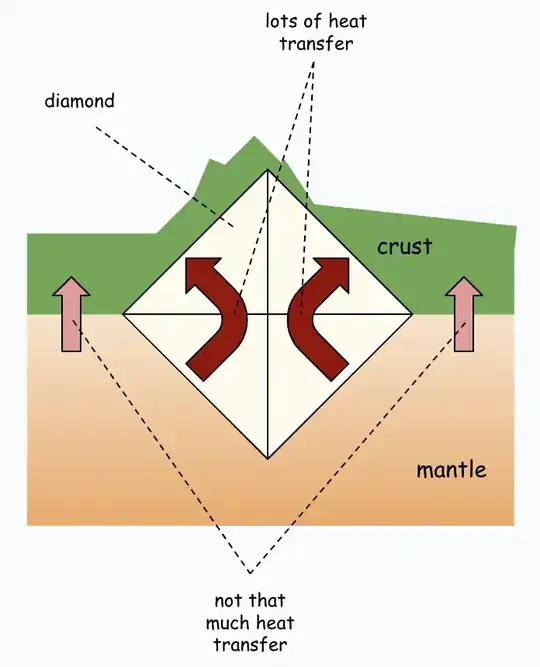

Here is a not-to-scale, side-on cross-section of a crust-covered diamond mountain made with Google Drawings:

  • The diamond is an octahedron approximately 56 kilometers to a side, with one vertex protruding straight up and one sunk directly down into the mantle. Roughly 9⅔ kilometers of the diamond are above sea level (albeit still buried in crust); the rest are either embedded in the crust or below it in the mantle.
  • Exactly half the diamond's roughly 10,863 square kilometers of surface area are in contact with a 1,400° Kelvin asthenosphere/upper mantle; the other half are in contact with the crust that sits atop it.
  • At 1,400° Kelvin, the diamond has a thermal conductivity of 500 W/m/K, and the crust has a constant thermal conductivity of 5 W/m/K.
  • The crust is 3.15 grams/cubic centimeter (presumed to be a 50-50 silica/magnesium oxide mixture), the diamond is 3.5 grams/cubic centimeter, and the mantle is ~3.6 grams/cubic centimeter (presumed to be pure magnesium oxide). The differentiation between all three is essentially total; this is, of course, unrealistic, but having distinct layers rather than a blurry transition between crust, asthenosphere, and mantle simplifies the math.
  • Radiogenic heat in the crust and mantle around the diamond-mountain is ignored.
  • The diamond has been in the crust for ~100 million years, and has had plenty of time to heat to permeate throughout it.
  • Gravity is 2.5G.
Given all the above: I need a rough idea of how the heat conducted by this diamond mountain will geologically affect its surroundings. Will it turn the area around it into a sea of lava? Will it cause hot springs and exploitable geothermal activity? Will the ground be only slightly warmer than it would otherwise? My greatest concern is that the sheer quantity of heat being transferred through the diamond may be enough to form a magma chamber in the crust above it before the crust can rupture enough to release it, resulting in a supervolcano.
Please show relevant math if at all possible, and if you need more data, please make a comment to that regard. If nothing else, I need to know what the temperature of the diamond would be so I can determine the heat it transfers into the crust.

So, there are a couple points that make a hard-science answer ...hard (no pun intended).
While the diamond itself is a great thermal conductor, it is only being heated by the mantle. And given the low thermal conductivity of the mantle, it will never be heated to the same temperature as it. Therefore this diamond would be behaving more like throwing water on the mantle - it will cool the area directly underneath it, resulting in a thicker mantle locally, and a warmer-than-average mountain. But it will not get hot enough for lava flows (but it will definitely have a different local climate and vegetation).
In terms of this "mountain" actually floating on the surface, the diamond vs. the mantle is only 0.1g/cm^3 buoyancy force, while the diamond vs the crust is 0.35g/cm^3. The volume of half of the octahedron is 41,400km^3, while the volume of the peak is ~600km^3. So there is actually negative buoyancy force on the diamond - it would be trying to sink deeper through the crust.
Also, the normal resting attitude of a d8 (an octahedron) is actually flat-side-up, not point-up, as can be seen in this video.
So a hard science answer would say your crust has to be much thinner, and/or the diamond much smaller. It would also be trying to tilt , so it would probably look more like a triangular mesa, with one peak perhaps reaching this 9.6km height.
