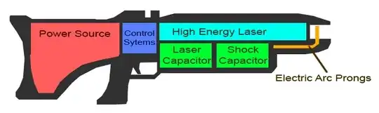

Bullets with capacitors in them might be useful in limited circumstances. The capacitor gets charged up with a few million Joules of energy. When it hits the target this energy is released somehow. Say by a short circuit or a closed circuit through a small coil. Again it is useful for touching off their ammo or frying their electronics.

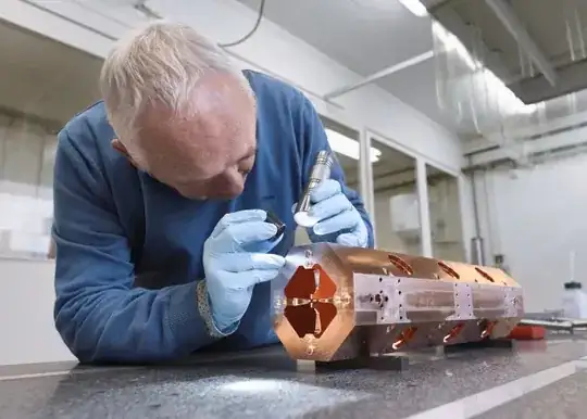

Perhaps not. That's a shot of a machine at CERN that, apparenty, is being setup to accelerate electrons and smash them together hard enough to - hopefully - blow them to tiny bits. (Presumably in God's mercy.)
OK, that's probably an extreme example. I'm sure we could get it down to a manageable size. Put it on a diet, get it to the gym, maybe shave a few thousand tons. Maybe something like this:
That's better, we can carry that
What do you mean that's only one component? Come on man, I'm trying here!

As far as a handheld device. A plausible work around was proposed. Using a "lower powered" laser to precede the ion beam and strip the electrons away from atoms, negatively ionizing the air between the positive ion beam emitter and the target, a fraction of a second before the ion beam fires. Thus producing a tunnel or conduit for the beam to travel through. This would look like a flash of light and a quick sharp crack!-CRACK! sound as the weapon fires.
