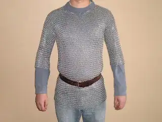

A way of simulating gravity which I've never seen in fiction:
Have the station sub-floor/centre made of magnetite. Preferably make the station floorspace a few metres above the surface of a giant magnetite lump.
Once you've established that, you need to get the inhabitants to wear chain-mail vests and trousers/skirts or equivalent, possibly leg-warmers - or clothing impregnated with magnetic plastic fibres (For a less strong effect):
Neat mail shirt
Copyright unknown 2022, via armormadeeasy. Fair usage.
All objects would need to be in ferrite (or ferrite impregnated plastics) or magnetic metal containers, food and drink would need to contain fine ferrite powder encapsulated in plastic Nano-beads to prevent undue wear of the tooth-enamel (recoverable from waste).
Where are you going to get the magnetite? Asteroids.

    No, no no. Fun thought, but you're ignoring the distance squared issue. Let's presume that the people just wear mail shirts. Any magnetic field strong enough to be noticeable at waist height would be too strong to stand up from if you fell over. And you'd fall over a lot, because you'd be seriously top-heavy. – Robert Rapplean Oct 20 '22 at 01:05
    Not if the magnet is below the floor. They don't need to get that near it. @RobertRapplean (OK, editing to clarify). – Escaped dental patient. Oct 20 '22 at 01:15
    @RobertRapplean: That would be the fourth power of the distance. – AlexP Oct 20 '22 at 06:57
    The force with which a magnet attracts a piece of iron decreases with the fourth power of the distance. It does not behave like gravity at all. – AlexP Oct 20 '22 at 06:58
    you could use electromagnets in both the floor and roof to generate a constant magnetic field (with some squiffiness near the edges of the room). Also the fourth power is wrong. A dipole field decays like the third power, but because we're relying on induced fields the force would go like the sixth but this is from a single dipole. An infinite plane of aligned dipoles (which approximates a room much wider than it is tall with aligned dipoles in its floor) would have a field dropping off linearly, giving an inverse square force on ferromagnetic objects – Tristan Oct 20 '22 at 10:45
    note that in the same approximation gravity is a constant field, so you're still getting different behaviour from the magnetite floor. Also note that water is slightly diamagnetic meaning it is repelled by magnetic fields (cf the ignobel prize for levitating a frog) so in principle this could be used to provide gravity (in the opposite direction) without requiring clothes, but would need much larger fields (and would probably feel very strange as your muscles would pull down on your bones rather than vice versa) – Tristan Oct 20 '22 at 10:50
  • Just make sure all computer data storage is on solid-state, non-magnetic drives. That much magnetism would probably not be great for a traditional hard drive. You could shield it, but shielding costs weight, and weight = money when you're talking about space. (Actually that might make those chain mail suits a bit cost-prohibitive as well come to think of it...) – Darrel Hoffman Oct 20 '22 at 13:53
  • Second, third, fourth power of distance shoudn't matter if you can move the magnetite far enough away. Remember that the floor is "a few metres above the surface of a giant magnetite lump". Change that "few metres" to whatever you need to get a usable field. Obviously, this a) may require a lot of magnetite, b) may result in a lot of wasted space, and c) doesn't resolve any of the other problems. – bornfromanegg Oct 20 '22 at 14:22
    Using magnets for gravity won't solve many of the physiological problems (like eye swelling) that occur when the human body is not exposed to gravity. Also using the toilet is going to be just as hard as it currently is in space (watch out for floaters). – user4574 Oct 20 '22 at 15:28
  • @AlexP, if the jacket were properly aligned magnetite, you'd be right, but with just a ferrous material, it's the square of the distance. https://socratic.org/questions/how-does-distance-affect-magnetic-force – Robert Rapplean Oct 20 '22 at 15:47
  • A problem with this is that the force isn't distributed throughout the body. Gravity pulls every cell in your body equally, so there's relatively little "squashing". But here, the magnet only pulls your external garments - basically your entire body weight will be sitting on your shoulders and hips. I can support my body weight comfortably, but an equal weight sitting on my shoulders would be very uncomfortable even if my body weighed nothing. – Nuclear Hoagie Oct 20 '22 at 16:34
  • I agree with a couple of things which are disadvantages - I'd suggest making the force less than the full weight of the person for ease of wear, and I'm not sure about the eyeball thing, I'd need to research how astronauts/cosmonauts coped with that particular side-effect. – Escaped dental patient. Oct 20 '22 at 17:59
    All you have to do is play with some magnets for a couple minutes to see how hilariously unfeasible this idea is. The magnetic force goes from incredibly strong to essentially 0 over very small distances and there's no getting around that regardless of what you do to compensate -- at best it will still be incredibly awkward vs normal gravity. – eps Oct 20 '22 at 20:30
  • There's also the fact that anything other than 1 flat floor will be practically impossible as the magnets would all be interfering with each other and pulling occupants in different directions – eps Oct 20 '22 at 20:36
  • On top of the other issues, objects containing or made of magnetic materials would stick to each other and to the user's clothes, experience odd torques, etc. And it'd be little help in managing food and drink, or other objects that can't feasibly be made to incorporate magnetic materials. – Christopher James Huff Oct 20 '22 at 20:45
  • You've got a point, maybe that's one of the reasons why no-one's implemented it in fiction or real-life. @ChristopherJamesHuff I'm becoming increasingly aware that I'd not thought it through.... – Escaped dental patient. Oct 20 '22 at 21:01
  • @Angry Muppet. I disagree with all the criticism of this. Don't listen to it. Even with current off the shelf standard gear that every system integrator uses, plus some nice electronmagnets, you could set up a field that adjusts in strength dynamically. Machine vision system + electromagnet array = this will work. With future tech, it's a doddle. You could couple it with very, very weak (and thus cheap) 'gravity' from rotation to make sure objects don't float freely. –  Oct 21 '22 at 06:31
  • Cover the leg warmers in pictures of traditional, Loony Tunes style horseshoe magnets. –  Oct 21 '22 at 06:38
