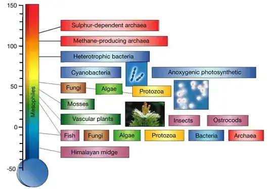

The question: what's the next problem? After septic shock, proteins denaturing, and cell membranes dissolving are overcome, what's the next overheating-related thing to cause physical harm to/kill this organism? Last I checked, it was up to 45°C - can it get higher?
I considered the ether-based cell membranes of archaea for this, rather than the extra-long-lipided ester-based cell membranes I actually chose, but they have rigidity-related, permeability-related, and transmembrane protein-related issues.
Just for context: this is an eukaryotic, multicellular organism, not an archaea. I would also point out that it runs on Earth biology, and that 100°C is likely an upper limit here, considering water boils at that temperature under standard temperature and pressure.
