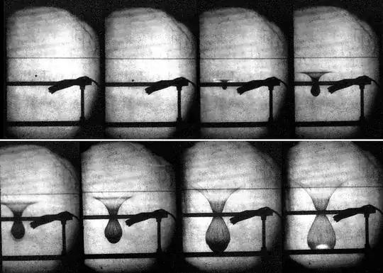

As you should already know, Whipple shields are not expected to stop everything. Here's what happens in an impact:
- The impactor hits your Whipple shield.
- It is probably denser than the shield and longer than the shield is thick.
- The impactor and shield act like liquids and splash off each other.
- Most of the impactor will continue on through the shield.
Your Whipple shield needs to be thick enough and dense enough that an impactor won't just blow through it without noticing. On impact, the tip of the impactor and the Whipple shield itself will splash out of the way, and unless the impactor is very small (like bit of gravel) most of it will carry on through.
The energy of the impact, however, will send a shockwave up through the impactor, and at least initially that shockwave will be strong enough that the molecular bonds holding the impactor together will not be able to resist it, eg. the end of impactor will explode. (I don't have any useful figures on the nature of this disruption... the design of Whipple shields shows that it happens, but the details of the why and how much are very hard to come by and might even be classified. Research on the effects of high-density projectiles is limited, and only seems to note that "they go through more armor").
The cloud of debris from the disrupted penetrator will initially still be very dense, and very dangerous, so you need to give it room to expand. How fast it expands depends on too many variables to consider here (the strength and density of the penetrator, the thickness and density of the Whipple shield, the spacing material or lack thereof between layers, the speed of the penetrator, etc etc). This is why Whipple shields require a standoff distance, to let the cloud of debris expand.
Instead of one long deadly penetrator, there are now a number of much smaller penetrators, spread out over a much larger area. The $\ell$ term is therefore much lower, and your armor thickness can therefore be much less.
(Image taken from Micrometeoroid and Orbital Debris Environment & Hypervelocity Shields, showing how important the standoff distance is.)

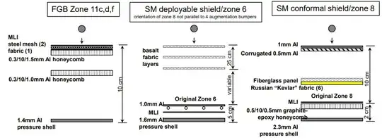

Here are some diagrams of real-world shields on the ISS:
Note use honeycomb and corrugated aluminium components, but for intermediate layers where they do a better job at catching hypervelocity crud without adding too much weight, not for outer layer spreadiness, see page 27 of the MMODE&HS presentation). There are two kinds of shield which don't have a solid outer layer at all, using either basalt fibers or woven metal threads. The non-metallic shields use much more spacing for the same protection. Other work mentioned in Shields for Enhanced Protection Against High-Speed Debris talk about
exterior “bumper” layers composed of hybrid fabrics woven from combinations of ceramic fibers and high-density metallic wires or, alternatively, completely metallic outer layers composed of high-strength steel or copper wires. These shields are designed to be light in weight, yet capable of protecting against orbital debris with mass densities up to about 9 g/cm3, without generating damaging secondary debris particles.
So what do we end up with? Well, its a bit boring and closer to old-school wet-navy battleship materials than cutting-age space age magic. Metal sheets work just fine, though if you're really weight-limited then fancier materials, especially in woven form, can also perform well. Aluminium sheet is OK... denser and tougher metals might be better, but research is lacking.
