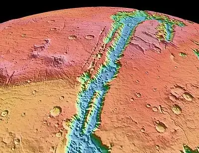

There is a crack in Mars called Valles Marineris. It is about as long as the contiguous USA.
A picture of Mars showing the US drawn over Valles Marineris
And here is a 3D rendering of it:
3D rendering of Valles Marineris
This rift is comparable to your specs in length and width, but not depth (only 7 km). 1500 km is a quarter of the way through Earth's surface to it's inner core. That would never be stable. So I think something like the Valles is the best you can do for a proper crack. Larger than this... maybe if you dried Earth's oceans and called the seafloor a crack (think of the Mariana Trench), this could work. Would be mostly shallower than Valles Marineris though.
