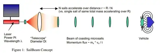

You should probably use a beamed propulsion system. Mass beam propulsion is probably the best type to use, with a particular favorite of mine being the late Jordin Kare's High-acceleration Micro-scale Laser Sails for Interstellar Propulsion (sometimes called "Sailbeam" for short).
Basically, you shoot very high velocity projectiles at your spaceship, which vaporises them and bounces them off a magnetic nozzle to provide acceleration. You can have a huge propulsion array left behind in the solar system using good old solar power to drive it, and have a much more svelte starship and no requirement for half a million tonnes of antimatter to remain well behaved for a decade. Mass beams also reduce the need for the sort of giant planet-frying laser arrays needed to push giant laser sail starships.

If you're using mass-beam propulsion to accelerate you up to speed, you need no reaction mass for the boost phase of your flight. Now, it is possible to use a mass-beam system to decelerate too, but it is tricky and risky so maybe don't do that.
