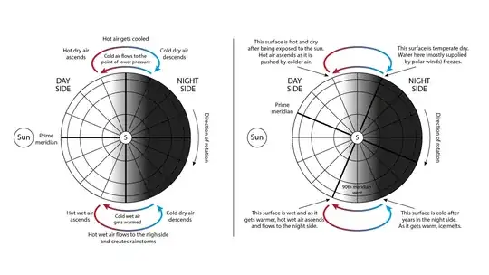

Since this planet spins (very slowly, but it spins), I see the sunlight sort of like a "heat ray" (to put it in plain words), from the surface perspective. This heat ray, with the diameter of a whole hemisphere, burns the land and evaporates the water, creating storms, as it slowly moves on eastward to the temperate zone. But in the other edge of the ray, the land reclaimed by the temperate zone is already burnt and dry, so hot air ascends, but it has no moisture to form rain clouds. Likewise, as the night side moves on, it freezes the dry land, but as it retreats, the frozen water stored in it melts by action of the day side.
I assume there would be a "drier" convection cell in the temperate stripe moving sunward, and a "wetter" convection cell in the temperate stripe moving nightward. This would be the diagram:
As the sun heats and boils the water, this hot humid air would flow in every direction to fill the void, so I would expect humid winds traveling through the poles, losing water and then regaining it from the ocean and creating new rain clouds. This could moderate the weather in the temperate zones and supply water tho the drier stripe moving sunward. I'm thinking that maybe, as the continent get cooler faster than the ocean, we could expect a phenomenon like the monsoon in India or El Niño in South America.
In regard to the stripe moving nightward, I would expect heavy rainstorms, violent winds, and in general a more inclement weather than in the sunward stripe. Also, colder water released by the night zone would cool down the continent, but maybe the sun moving on and boiling the oceans could regulate the temperatures.
