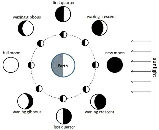

For a reference, look at the diagram of the moon phases
You can see that there is almost always a portion of the moon which is both on the half away from the star and on the half away from the planet. At first quarter and last quarter that correspond to a whole quarter of the moon, at the full moon it would be a whole half moon.
This portion of the moon would therefore receive no light.

Perhaps the closest you could get is to put the "moon" in an orbit around the L4 or L5 Lagrange point. That would still leave about 60 degrees of the surface in shadow though.
Another idea... You could have a ringed planet where the ring material is highly reflective, with the moon inside the inner radius of the rings. A bit of googling tells me this is possible. Worst case, the moon is in shadow of the planet, and a portion of the rings near the moon are in shadow, but there should still be illuminated ring material visible from all points on the moon's surface.
