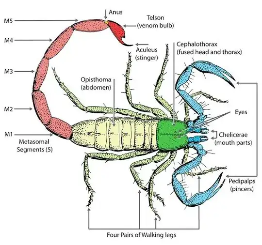

1- it needs to be long. The scorpion tail is actually its segmented abdomen, and remember:
The yellow part is also the scorpion's abdomen
So basically, a scorpion like motion means a very long tail, which also means a very long spine,which brings us to problem 2:
