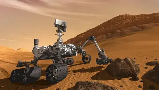

Remember this thing weighs about 1000kg:
Your 20 tonne robot needs 2 feet about twice as wide as the wheels on Curiosity.
Those wheels are 40cm wide, but the rover is riding quite high normally - only about 1-2cm of the wheel touches the surface in normal (non-bogged) operation - each wheel is using about 60 sqcm of surface area at any one time, ~360sqcm total for the entire 1 tonne rover.
Multiply it out for a 20 tonne robot, 7200sqcm needs to touch the ground to support that weight. That's 0.72 square meters. Allowing 1 foot to be in the air while walking, square feet of 85cm should support a 20 tonne bipedal walker robot on mars.

Note though that Curiosity rolls, and has a constant pressure on the surface, while walkers would have repeated impulses, which would definitely throw up more sand. I still think you're right, though, that it would probably be fine. – Benjamin Hollon Jul 16 '21 at 16:33
