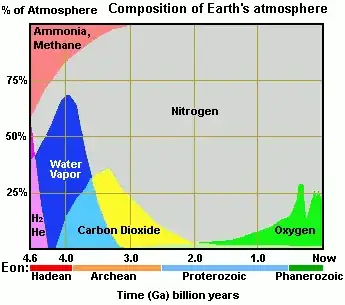

For Archaean Earth's atmosphere, most sites list elements of the atmosphere without any estimate on percentages. This is the only site where I could find a general composition estimate.
I see a composition that is roughly 70% N, 10% CO2, 10% CH4, and 10% H2O vapor.
