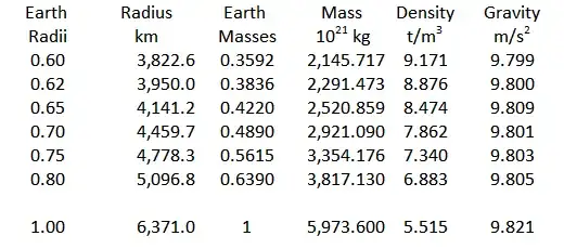

Using the same methodology I used in my answer to How Big Can a Habitable Planet Get Before Its Gravity is More Than 0.8 m/s² above Earth's 9.81 m/s²? I've made the following table. The last line is data for Earth.
A planet that has a radius that is 0.62 the Earth radius and 0.3836 the mass of the Earth will have a surface gravity very close to $g$ and an average density of 8.876 t/m3 (g/cm3). This density is very close to the density of Kepler-10b.
