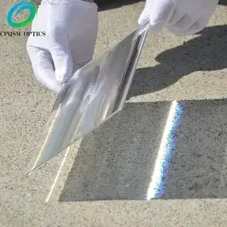

They can, if you provide instruction how, to concentrate solar radiation. Naturally occurring Rock crystals include quite transparent specimens and a million elves can grind and cut quite a lot of optical elements - not necessarily of perfect quality but overtake the problems with quantity - things do not have to be perfect from the start - they will resort to better means and ways later, they just need an initial kick.
