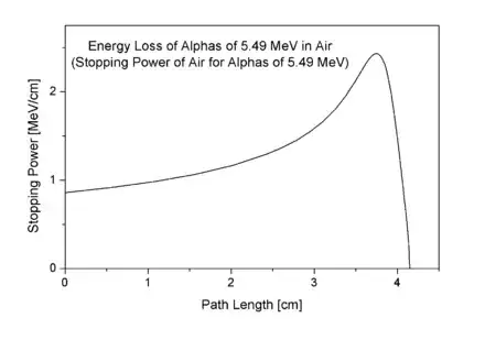

Alpha particles... are relatively heavy, and only travel about an inch in air. Alpha particles can easily be shielded by a single sheet of paper and cannot penetrate the outer dead layer of skin, so they pose no danger when their source is outside the human body.

Air blocks alpha radiation: https://en.wikipedia.org/wiki/Alpha_particle

Alpha radiation is the stuff a piece of paper, or a few inches of air, or your skin, blocks pretty well. They are heavy and charged (they are high velocity helium nuclei). The danger here is from radioactive dust, where the radioactive particles gets into your body. Magnets would work horribly against this, as its charge/mass ratio is really low.

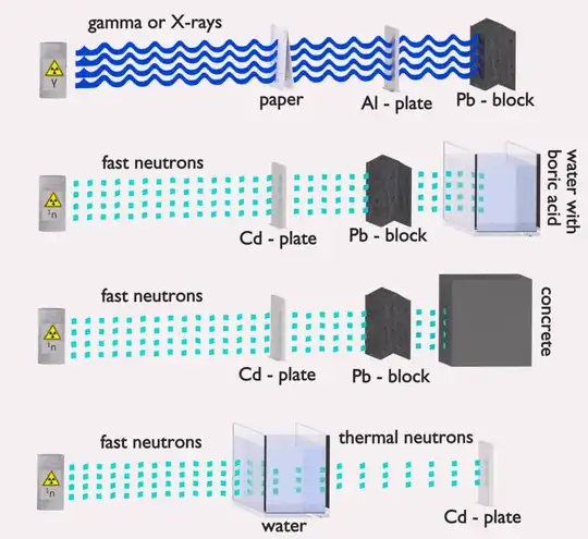

Neutrons are shielded by water. During the Apollo moon missions, the astronauts who walked on the moon worn liquid cooling garments like the one pictured below. This produced a "zebra like effect" where the astronauts had warm and cool stripes.
Such garments could be made to reduce the "zebra effect" by having infill tubes and thus providing more coverage to the body. Such a suit, filled with water could shield the body against neutrons.
The trick with all this is the ordering of the layering.
Closest to the body a person would require a neutron shielding water suit filled with water and boric acid. This would then be covered with a lead wool garment to shield against gamma radiation and some neutron radiation. Covering this layer would be thick clothing to shield against alpha and beta radiation.

that image is utter bullshit. Neutron radiation is hardly a thing - it decays so fast to electron-proton, Where the proton combines with neutrons to form alpha radiation. You'd have to be close to a particle beam for neutron radiation to be more a problem than beta/alpha/gamma. – paul23 Mar 18 '21 at 17:45
And then the images themselves: they are very very misleading. Without thicknesses or better explanation it's worth nothing. (Why would we need lead when first trying to block by cadmium and then water - but not when doing the opposite - that's not a thing). The terms are also silly what are "fast neutrons" and "thermal neutrons". – paul23 Mar 18 '21 at 17:48
Oh and I wish to add: a surface of lead that blocks gamma radiation - will also block to equal extend the neutron radiation – paul23 Mar 18 '21 at 17:49
1@paul23 while I agree with the rest of your criticism, "fast neutrons" and "thermal neutrons" are very much a thing, and they have different absorption properties. So-called neutron moderators can turn fast neutrons into thermal neutrons and are used in most of the nuclear reactors. It is possible to build nuclear reactors without neutron moderator, but those need more fissile-rich fuels and currently are in the minority. – moonwalker Mar 18 '21 at 20:05

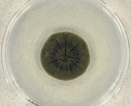

As others have noted Alpha and Beta particles can be blocked fairly easily. If you wanted a more flexible material that might be effecting in blocking gamma and neutron radiation as well, may I suggest fungus!
There has been some research recently on radiotrophic fungi living in the ruins of the Chernobyl reactors. A study on the ISS looked at blocking radiation using these very fungi and showed promising results: https://www.biorxiv.org/content/10.1101/2020.07.16.205534v5

The fungi might survive there, but do you have any indication that they block radiation? It goes against all I know of physics. – o.m. Mar 18 '21 at 17:49
1the fungi are not any better at blocking radiation than a layer of leather. – John Mar 18 '21 at 19:38
Nice out-of-the-box solution. Looking at the numbers though... ~2.17% reduction of ionizing radiation, apparently due primarily to the melanin content of the material, is not particularly significant. The ~98% that passes through still needs to be dealt with. – Corey Mar 18 '21 at 23:18
@o.m. Most things block ionizing radiation to a small degree. This fungus (Cladosporium sphaerospermum) does a better job than some other light materials because it has lots of melanin - about 8.6% by mass apparently. The main interest in it is that the lift mass is small since it can be grown in place. – Corey Mar 18 '21 at 23:22
