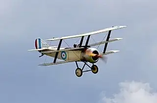

I like aircraft with multiple wings stacked atop each other; in an alternate world (undergoing a similar technological history to our planet but with a different aesthetic) I would like them to remain dominant for both commercial and military purposes: multiplane equivalents for everything from 747's to F-16's.
Historically, multiplanes offered considerable advantages over monoplane designs; you have more lift with a narrower wingspan, and the rigging made the wings a lot stiffer as well. But from my (layman) research it seems that multiple wings are a cause of excessive drag at greater speeds, which became available towards World War 2 as engines became more powerful.
