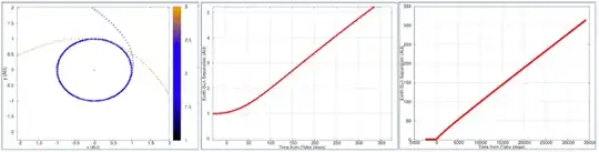

I understand that there is an infinitude of angles that a massive body could approach the Earth in order to fling it into space; that some trajectories might bring us closer to the sun before we are finally ejected; and that for different trajectories, we will have different timelines. What I am looking for is one specific scenario, with the following hard requirements:
- The Earth is only ever accelerated prograde - this will keep it from approaching the sun, while also keeping things simple(r) (I hope).
- The Earth is accelerated from its current 30km/s to 45 km/s orbital speed just once. No multiple passes.
- The acceleration is gentle enough that humanity can survive it. We're all going to die for a number of reasons as the Earth cools down, but the initial acceleration itself should be survivable by at least some people.
And one optional requirement:
- The Earth keeps the Moon orbiting around it.
I am giving Earth a boost to about its escape velocity + approximately 3 km/s in this case, so from that I could work on figuring out when the Earth would cross each planet's orbits - but I don't know how to figure the temperature changes by week, month or year. Please help me with that. Notice that the video and the article in the links provide no initial departing speed.
