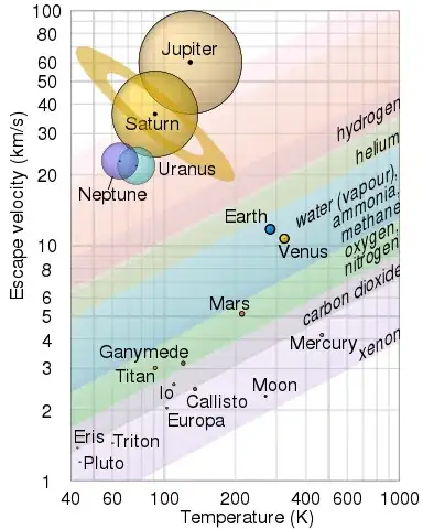

The type of atmosphere that a celestial body can in principle retain is a function of the surface temperature and escape velocity.
If you look at the chart below
you see that even a smallish body like Titan or Ganymede can keep oxygen. If the moon has then tidal heating or geothermal activity to supply for the lacking of stellar supply it can surely have the conditions for supporting life as we know it. Which is precisely why scientists are being so careful in not contaminating bodies like Saturn and Jupiter moons, because they are potential good candidates for life search.

1It should be noted that this applies to long time scales. If the Moon suddenly had an earth-like atmosphere, it would stick around for maybe a thousand years or so before it escapes. If a low-gravity, high atmosphere planet/moon is desperately required, you could have the atmosphere be "refilled" constantly--maybe by a collapsing ring of ice-asteroids or something similar. – Dragongeek Dec 03 '20 at 10:07
It's worth noting that planets with a strong magnetic field due to a molten iron core with a dynamo effect (like earth) are able to deflect solar wind and retain atmosphere much better. Mars is believed to have had a thick atmosphere with water vapor for the first billion or so years of its existence until its core cooled and it lost its magnetic field. Venus, the planet with the thickest atmosphere in the solar system, is not believed to have a dynamo effect, possibly because of size or some other effect, but it maintains its atmosphere through volcanic activity and a complex magnetic interaction in its ionosphere. It has, however, lost most of its water due to the solar wind.
Basically, it's reasonable to say that there are other factors than just planet size that determine atmosphere retention. You could reasonably say the moon has unusually high amounts of decaying elements in its core, resulting in a high temperature and strong magnetic field, or that some cosmic fluke (another planet is deflecting solar wind, aliens set up a magnetic satellite to shield the planet) is at play.
