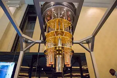

Quantum computers are large, but they don't have to be...
Most quantum computers are very large. For example the D-Wave quantum computers are the size of a room and have a very large refrigeration system. The fact is, these systems don't need to be so large. They are designed to be the size of a room because they are experiments, and as such its useful if two or three scientists can walk inside and debug stuff. Also most of the components are off the shelf rack-mount equipment, because the quantum-computer company wants to work on the quantum part of the project rather than distracting themselves by designing lots of custom peripheral components.
The actual quantum processor in these systems is the size of a postage stamp. And if you skip the refrigeration system and just use some temporary portable coolant, it could fit in your pocket.
