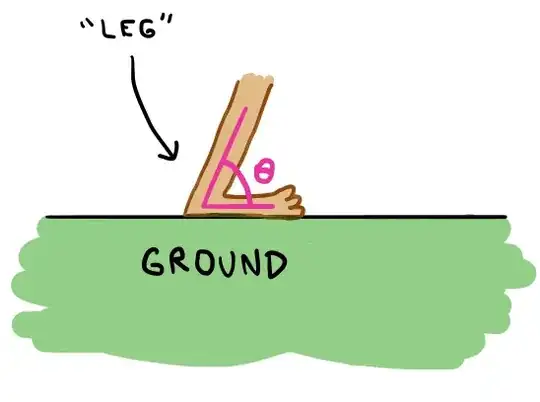

Although low-gravity makes it much easier to travel long distances while airborne (as other users have noticed in their answers and comments), it might actually make it more difficult to move quickly, i.e. achieve a high velocity by accelerating quickly. This is because most land animals require contact with the ground in order to accelerate, and low gravity means that animals will remain airborne longer in between “footsteps.”
Suppose we have an animal that accelerates by running similarly to humans, rabbits, etc., by pushing against the ground with a leg-like appendage at an angle $\theta$.
Suppose this animal has mass $m$ and is capable of applying a force $F$ with its leg and maintaining contact with the ground for $t_c$ seconds. This force $F$ can be separated into horizontal and vertical components.
A force with magnitude $F\sin\theta$ is directed vertically and perpendicular to the ground, meaning that the normal force from the ground will propel the animal into the air with a vertical velocity of $Ft_c\sin\theta/m$. Assuming the ground is approximately flat in the direction of travel, the time elapsed before the animal lands on the ground again is equal to
$$t_{\text{land}} = \sqrt{\frac{2Ft_c\sin\theta}{mg}}$$
Additionally, a force with magnitude $F\cos\theta$ is directed parallel to the ground. Assuming that friction is great enough for no slippage to occur (which admittedly may not be the case when, say, there is snow on the ground), the horizontal acceleration is $F\cos\theta/m$ and the increase in horizontal velocity is $Ft_c\cos\theta/m$.
Assuming $t_c$ remains constant regardless of the animal’s velocity and $t_c << t_{\text{land}}$, we have that the animal is capable of increasing its horizontal velocity by $Ft_c\cos\theta/m$ every $t_{\text{land}}$ seconds. This makes for an effective acceleration of
$$a_{\text{eff}}=\frac{Ft_c\cos\theta}{mt_{\text{land}}}=\cos\theta\sqrt{\frac{2Fgt_c}{m\sin\theta}}$$
What does this tell us about animals on your planet?
  • Since $a_{\text{eff}}$ is proportional to $g^{1/2}$, and your planet has a gravity $1/10$ that of Earth’s, you should expect analogous animals on this planet to accelerate $1/\sqrt{10}\approx 0.316$ times as fast.
  • Sorry, but airtime will almost certainly make up (much) more than $10\%$ of the time. If you want to fix this, I recommend designing an animal with a very small value of $\theta$. This causes the majority of propulsion force to be horizontal, but the animal will probably need some sort of “friction pads” on its feet to prevent slippage in this case.
    • $\theta$ really does make a big difference. For small values of $\theta$, halving the value of $\theta$ increase $a_{\text{eff}}$ approximately by a factor of $\sqrt{2}\approx 1.414$.
  • I didn’t do the calculations here, but the coefficient of friction and the possibility of “slippage” could make a big difference. I’d expect animals in low-friction environments (e.g. wet and snowy ones) to use much different transportation methods than those in high-friction environments (e.g. grassy and rocky ones).
That being said, all animals on this planet will have the same difficulty with accelerating. Evolutionarily speaking, since predators will also move more slowly, there’s no reason for animals to evolve the ability to move anywhere near Earth-level acceleration speeds.
