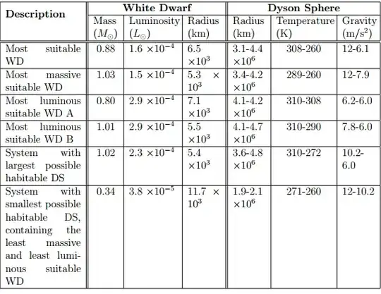

It depends upon the size of Dyson Sphere you are making.
My other answer about Dyson Spheres indicates that spheres with a 10 M shell thickness around white dwarf stars only require materials massing about 1 Earth sized planet's mass.
Such Dyson Spheres have the added benefit of putting the materials under much lower stresses.
According to the paper you seem to be citing, the construction materials would actually be under impossibly high stresses. I'm trying to figure out if this can be rectified by making the sphere larger, but my physics-fu isn't what it used to be. – Blazemonger Mar 26 '16 at 23:31
It's been a while since I did a calculation of the stresses involved. But most of the time that I see articles like this, they ignore the required strength of materials. They do the analysis as a mind game and not intending it to represent a real-world structure. I'll have to play with the numbers later and see if they look right. The engineering is pretty simple. Just treat it like a pressure vessel. – Jim2B Mar 27 '16 at 20:00
