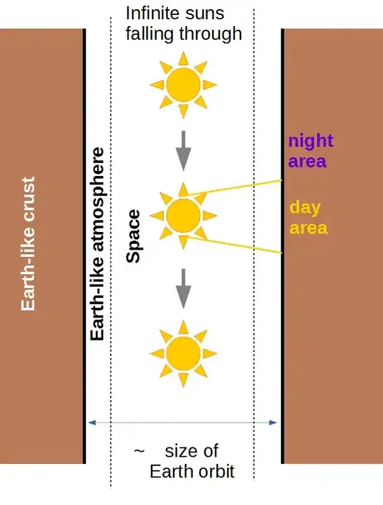

Let me start with the additional problems that arise:
- The trajectory of the suns is not stable. If they are slightly off-center, gravity will pull them towards the side of the cylinder that they're closer to, analogous to the ringworld stability issue. You could work around this by using stellar engines of some sort to keep the stars centered, or making the cylinder a tiny bit flexible and using motors to change its shape dynamically....
- There is nowhere for the heat that is generated by fusion in the cores of the suns to escape, apart from conduction through the crust towards outside space. You could work around this by putting large holes in your cylinder through which outside space is visible, by making your crust very thin (on the order of meters), or by making it very conductive (by adding an active cooling system that pumps heat outside). This oversimplified illustration shows the relevant mechanisms that keep earth's surface at its equilibrium temperature, and how the inside of your cylinder would heat to over 2 million Kelvins without any countermeasures:
Now, to your actual question.
The only relevant parameter is the distance between the suns, in AU. The speed at which they move follows automatically from your requirement that one sun should pass every 24 hours. It will be rather high, though :)
You will, of course, always see an infinite number of suns, but most of them will be very dim and very close to the horizon. Here's what the sky will look like, with the apparent brightness of the suns (= the area they occupy in the sky) written next to the dots.

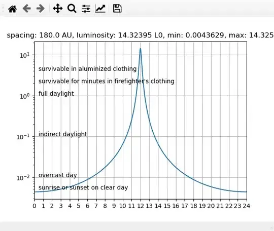

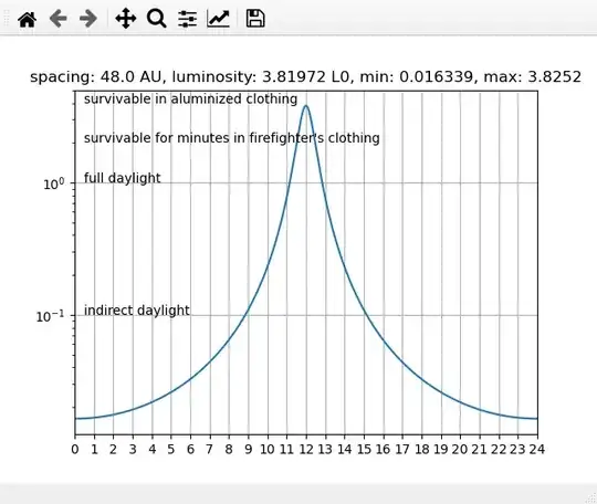

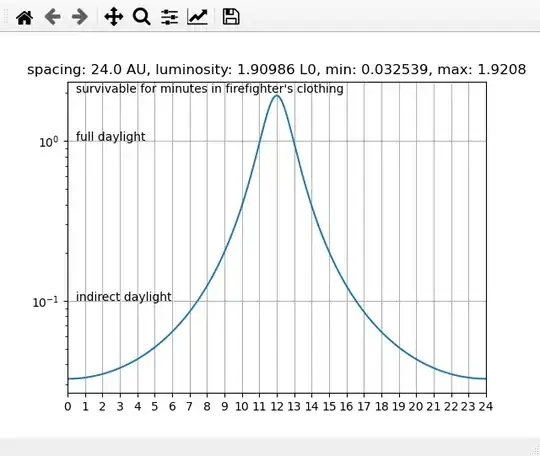

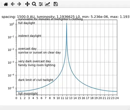

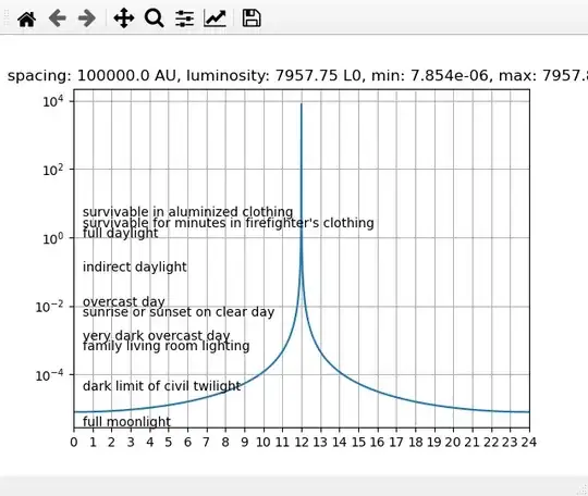

And plots for some distances:
Distances above 180AU are impossible because then the suns would be moving faster than the speed of light; decreasing the cylinder diameter would solve this.
In these cases, I try to maintain the same average heat flux that is experienced on earth, to allow meaningful photosynthesis. You can see that if you want proper darkness at night, there will be short hard bursts of heat which will only be survivable in underground bunkers.
