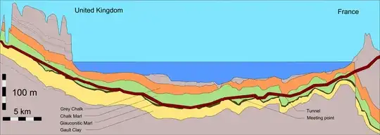

@mlk I've edited to explain why it's a vee the whole way through. The problem is, it's a shallow vee, somewhere between 0.05 and 0.25%, so e.g. at 0.1%, 10m of distance down the tunnel for every 1cm of water height. Also the laws of wind/differential pressure apply, so if the wind or baro pressure difference is 1cm of water column, it can push 1cm (height) of water out of the way and still blow the wind through. 1cm of height amounts to 10m of grade in two directions, so 20m of tunnel fully drowned, and another 10m on each end with only 1cm of air pocket. – Harper - Reinstate Monica Jan 28 '20 at 14:25
2@Harper-ReinstateMonica you probably want to edit your title. It will "block" the tunnel with water or something similar, but it won't "fill" it. Or it will "fill the bottom". – jcaron Jan 28 '20 at 14:28
@jcaron Good idea, I did (about 10 minutes after you suggested it). – Harper - Reinstate Monica Jan 28 '20 at 22:22
2As for the (to me: unexpected) shape, see https://commons.m.wikimedia.org/wiki/File:Channel_Tunnel_geological_profile_1.svg – Arjan Jan 28 '20 at 23:08
@Arjan Good find, thank you! That illustration shows 50:1, and it's steeper (and more irregular) than I thought it would be. Bottom-vee flooding will happen faster than I opined to mlk. – Harper - Reinstate Monica Jan 28 '20 at 23:23
