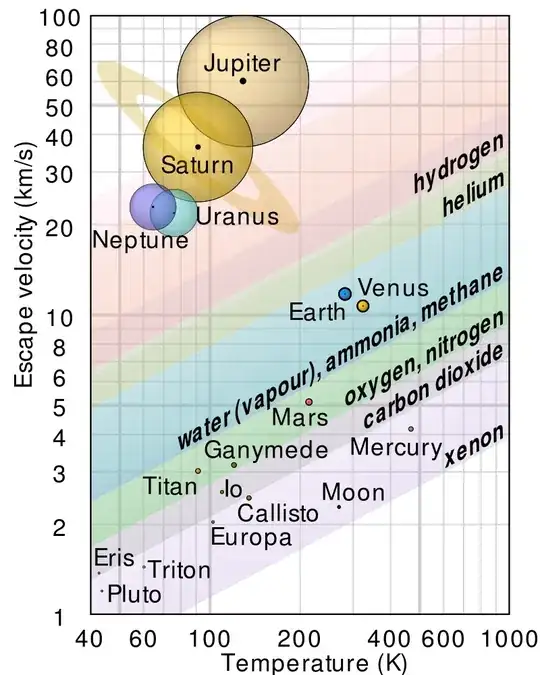

You're limited in part by the mass of the Earth. Without drastically shrinking the planet or reducing its density, its gravity will be the same, meaning it still holds on to its atmosphere relatively well.
Compare the locations of Earth and Pluto on this graph. Without moving Earth so far away from the Sun that it's as dimly lit (and therefore cold) as Pluto, or reducing it in mass to bring it to such a low escape velocity as Pluto, Earth will always be able to hold a much thicker atmosphere. That insulating air should always retain a little more heat.
