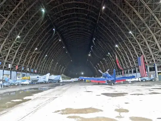

Tillamook Air Musem Source: https://wandering-through-time-and-place.com/tag/tillamook-air-museum/
This is the Tillamook Air Museum. It was initially a hangar for zeppelins.
Airships! Source: same as above
This structure is 58.5 meters tall (192 ft) and 90 meters wide (296 ft). This is the tallest one I could find.

    Constructed by the US Navy in 1942 during World War II for Naval Air Station Tillamook, the hangar building housing the aircraft is 1,072 feet (327 m) long and 296 feet (90 m) wide, giving it over 7 acres (2.8 ha) of area. It stands at 192 feet (59 m) tall. The doors weigh 30 short tons (27 t) each and are 120 feet (37 m) tall. Hangar "B" is one of two that were built on the site originally, Hangar "A" was destroyed by fire in August,1992.[2][3] https://en.wikipedia.org/wiki/Tillamook_Air_Museum So it is only 59 meters or 192 feet high, not 326 meters or 1,072 feet. – M. A. Golding Jan 11 '20 at 17:15
  • @M.A.Golding thanks for the heads up, I've fixed my answer. – The Square-Cube Law Jan 11 '20 at 19:20

Renan's answer states that the giant hanger at the Tillmanhook Air Museum, Tillmanhook, Oregon is 326 meters or 1,072 feet tall. However, that is the length and not the height of the hanger:
Constructed by the US Navy in 1942 during World War II for Naval Air Station Tillamook, the hangar building housing the aircraft is 1,072 feet (327 m) long and 296 feet (90 m) wide, giving it over 7 acres (2.8 ha) of area. It stands at 192 feet (59 m) tall. The doors weigh 30 short tons (27 t) each and are 120 feet (37 m) tall. Hangar "B" is one of two that were built on the site originally, Hangar "A" was destroyed by fire in August,1992.2
https://en.wikipedia.org/wiki/Tillamook_Air_Museum3
The much lower actual height of 59 meters or 192 feet is still impressive.
The hanger has lasted for about 78 years since 1942 and it could last for centuries if it never catches fire like its twin did.
