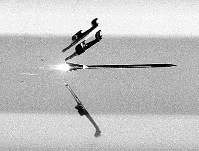

This is why real world armour penetrating rounds are long and thin, like this APFSDS antitank round: APFSDS round in flight
If you fired your bullet at relativistic speeds (say, 90% of the speed of light or more) you might find that some of the incoming round makes it out of the other side, perhaps in the form of a few stray antineutrons, but I'm guessing that isn't really what you wanted. Also, if you've got a relativistic gun, you may as well fire regular matter out of it, because all the oomph is in the kinetic energy, and the contribution of the mass-energy in an antimatter bullet would quickly become negligible and certainly not worth the hassle.
