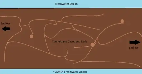

I've added a quick sketch below. This is a cross section where the vertical axis of the image represents the up-down axis in the world and the horizontal axis of the image represents some axis perpendicular to that.
